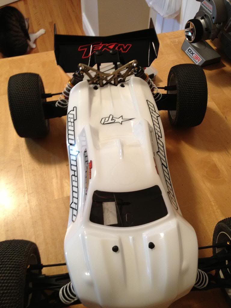

i have not seen too many of these truggies converted so here is mine
i had it out last weekend and it works pretty good i will have to clean up the wiring some and figure out a receiver box, but it works really well so far ,thanks RC monster for the conversion kit everything fit great
Team Durango DNX408T
Spektrum DX3R Pro
Spektrum S8000 servo
Tekin T8/2250
Thunderpower batteries

Could you flip the center diff so you could use normal pinions? Looks like there would be room to do that.
N. Rustler conversion
10.09.2012, 09:46 AM
That's a good looking Truggy for sure!!
You'd have to cut a new slot in the chassis for clearance or raise the diff.
10.09.2012, 09:47 AM
Ps the cd top plate looks the wrong way around.
10.09.2012, 12:45 PM

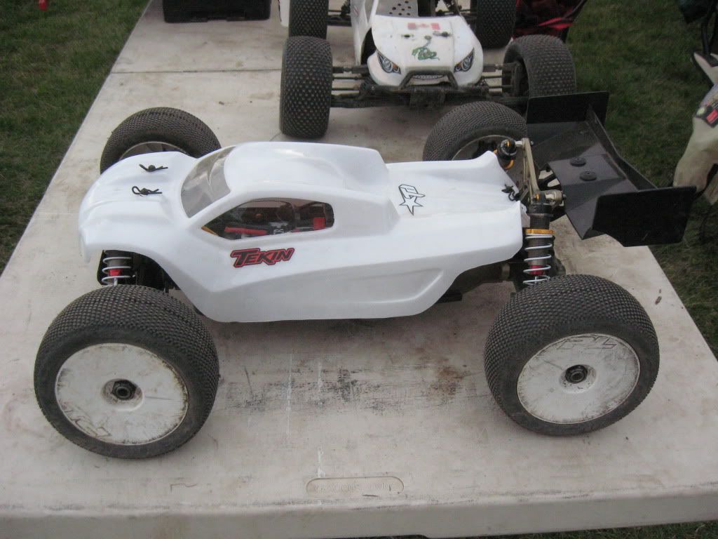

You can see in the second pic the cutout in the chassis for spur gear clearance isn't under the spur gear. That center diff is in backwards. That's also why the top plate looks the wrong way around.
lstmuggy- is there any special reason you flipped the diff? Only had long pinions on hand? Good looking truggy, by the way

Instead of cutting a slot you could also use of piece of CF under the CD. cutting a slot in the CF instead.

yes the top plate was put on wrong lol hurry to take pics, i have since flipped the diff around and just raised the diff about 1 mm,i didnt like using the long shank pinions.
the truggy runs great tons of steering just have to watch the wheel pins (they like to work themselves loose
