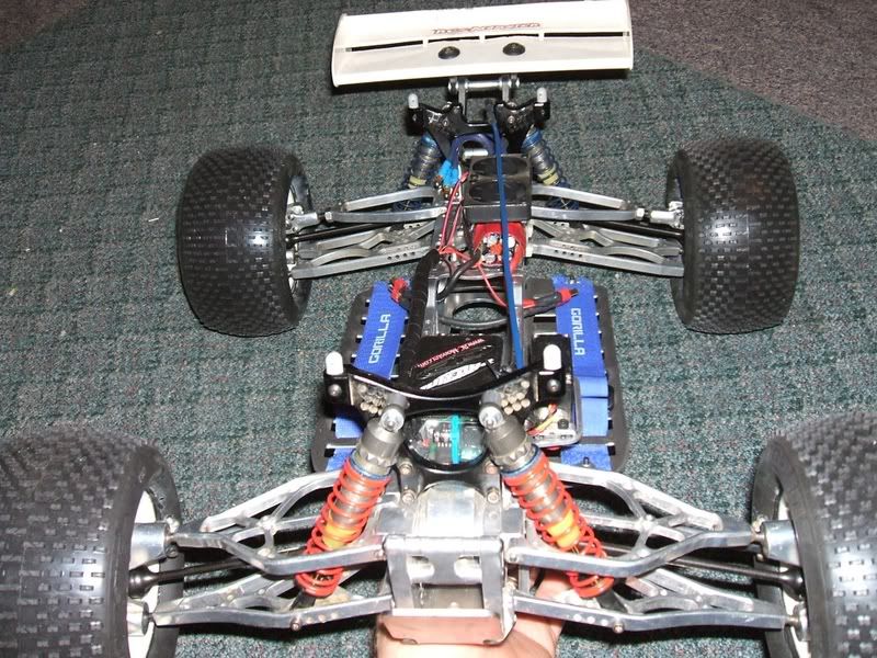

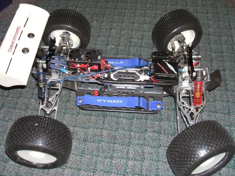

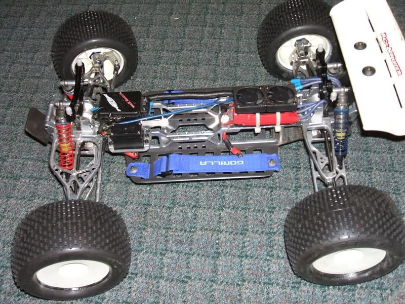

it is very understandable that you do not want to take a pic of the wiring because you would have to unwire it. Thats cool but if you dont mind taking a pic of the fans mounted to the heatsink. that would be good just to see what it looks like because i have not seen this yet. thanks
sjcrss
Hyper 7 Erevo Center Diff
sjcrss's Avatar
Posts: 1,195
Join Date: Dec 2005
Location: CNY (Syracuse/Binghampton area)
11.24.2006, 09:16 AM
I actually don't use that heatsink, it is a mount that i made for my 2095 controller.....but here you go anyways

11.24.2006, 09:17 AM
and here
and finally

11.24.2006, 10:41 AM
sweet thanks thats what i wanted to see
