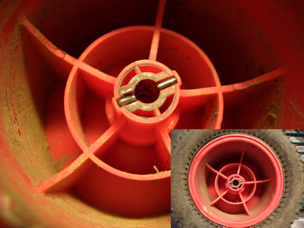

Got the controller and motor together in my XXX-T MF today. I put a 16-tooth pinion on the motor, got things lined up, put the battery in and let 'er rip.
At first, I wasn't very impressed...then I realized I had put in a battery that had false-peaked...DOH!
With a freshly charged 6-cell IB3600 pack it was fun watching the front end pull off of the ground at about 15-20MPH :)
The diff held up for the first pack, but I managed to break something else (see the attached pic). Needless to say, I'm pleased with the power so far ;)

05.18.2005, 04:35 PM
Don't worry. I have about 30 extra spares of those lol. After breaking a few from racing I replace them every once in a while. It hasn't been a big problem unless im jumping.

I got the xl5000.
That's the first axle pin I've ever broken. It's one of the few parts that I don't have spares hanging around for. :)
I'll probably pull one from my TC4 just to play more until I get some spares.
