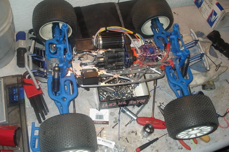

after most of the stuff is taken off..
06.19.2007, 05:41 PM
You dont get much chassis for your money do you?! But I think thats the whole idea. The emaxx tranny should bolt in fine, but you will definately have to buy/build some proper battery trays for it. Those diffs are very weird, but being UE with 1/8 gears should make them indestructable with the HvMaxx- just be aware that on 14.4v you will want a gear ratio of between 25-30:1 overall, depending on weight, but that should be a pretty light truck when its finished~ 9-11lbs maybe.

That's probably 7071 aluminum, which is incredibly strong for its weight,also very expensive

lol i wouldnt know.. i didnt buy the stuff!!
and ya i noticed that too.. the chassis is pretty small... ill probably either put the battieres like on it's side vertically or stacked on top of each other... i am going to try and find some bl t-maxxes to see what kind of things they did.

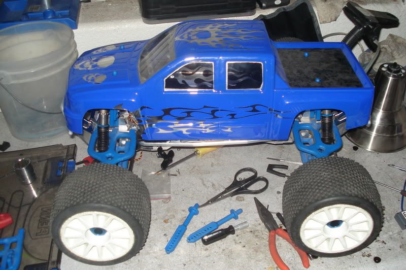

a pic with the body and tires
i have never actually done my own conversion and now i understand why you guys do these!! they are so much fun! especially when you know its going to turn out awsome!! CANNOT wait till the stuff comes!!!!

so i got the truck in! started taking apart and took some pics!!
my awsome wiring
after i installed the deans
will get some pics of how i might set up the batteries tomorow when i have some more time!
