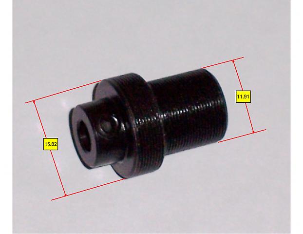

Could someone with one of the LST 2 speeds please measure the diameter of of both threaded parts on the pinion carrier. Mine measure 11.78mm OD on the on the 1st gear and 14.8mm OD on the second gear (I realize this doesn't take into account the thread pitch) If the are the same diameter I'm willing to bet they have the same pitch.

I just measured the OD of the 2 speed adapter that is sold in the rc-monster store. they 1st speed OD is 11.91mm and the 2nd speed OD is 15.82

EDIT: Just to be clear here is a picture with dimensions of what I measured.

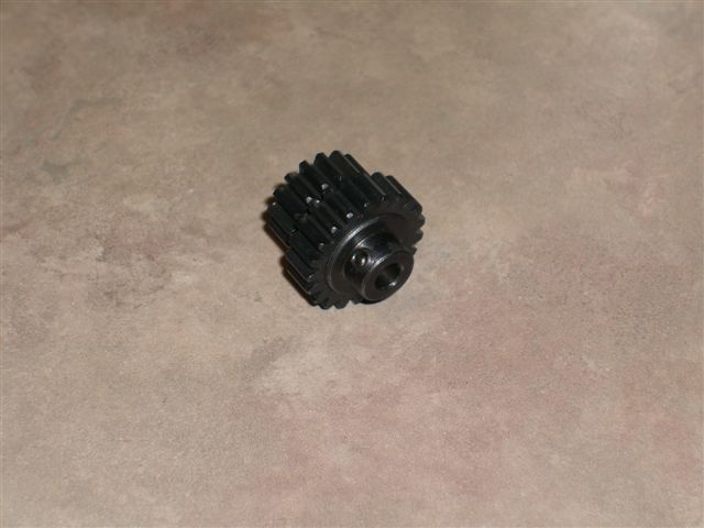

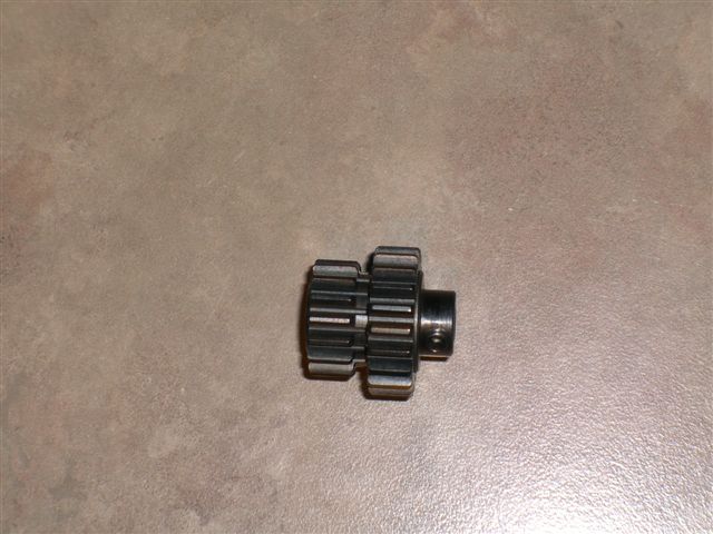

No it doesnt overhang. It comes almost exactly flush to the back of the threaded area. The first speed gear goes on almost exactly flush to the front of the carrier.
Here are a few pictures that show the assembly a little better than the pictures in the store. This is the 16T first speed and 21T 2nd speed gears and the 2 speed adapter.
EDIT: The gear faces themselves are 6.8mm wide. The first peed gear has a collar addtached to it to space it from the 2nd speed gear
