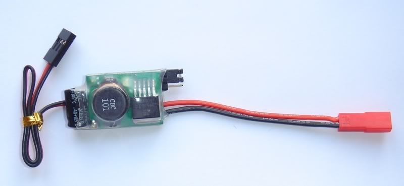

Thankyou everyone for your help, I have now bought everything I need. I went with a cool little UBEC I found on ebay- a few people on RCM use them and report good things about them, so I went that route:
6v/3amp switching bec- I will remove the red connector and solder it my esc battery leads.
