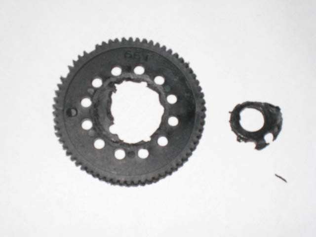

So I decided to havea little fun today and get more facts. So here is what I learned.
1) I am geared 16/66, I have a 18 pinion, should I be putting that on?
2) In 1st gear 45 degrees outside bash type running Motor came in at 160 degrees, Batteries 95, and esc was 55
Changed to a fresh pack, shifted to 2nd gear and ran for 5 min. This is the result :( See attached pic
3) Motor temp was 130 degrees, But to be honest I don't think it was up to full temp yet since I had not been running that hard. Acceleration was not near as good.
So what should I do now.
I am thinking for back yard bash maybe I should use 18/66 and stick to 1st and see what happens.
How much more gearing does 2nd gear give another 20% or so?
What should I do about slipper, It almost looks like the pegs wore down then things over heated melting the center hub, then do to being out of round the spur teeth got shreded. Does that sound like the norm?

01.12.2008, 06:35 PM
Nasty. Looks like you had too much slip set (any slip is too much with the stock slipper & a powerful motor), so the pegs melted due to a hot slipper plate, which then melted the center out of the spur. Best fix for that is an aftermarket slipper (RR, Strobe), or modifiy your tranny input shaft to accept a revo or jato slipper (requires drilling a hole in the put shaft). Quick fix is to fill all the slipper peg holes with the pegs, then crank the slipper all the down.
gtxracer
HOOH HUAH HOOH! Aww Baby!
gtxracer's Avatar
Posts: 868
Location: olyWA
01.12.2008, 06:47 PM
Or you could get a Strobe sprong. I believe they work with E trannies. Check out www.unlimitedengineering.com and post a wanted ad in the B/S/T section. I saw one go earlier this week for $20.

01.12.2008, 11:33 PM
Well I don't want to bail on a slipper, Since I have not done up the Diff's or the outdrives to Revo or CVD's, I feel the slipper is saving them, So I looked and the RR did not look bad but...... Can you get spur gears if you kill it or you need the whole kit again.. if so No thanks looks like a way to waste money.
Next I looked at the Revo Slipper, Is it just a matter of drilling a hole for the pin to go into? That seems easy enough, However it looked like the spurs were all real low tooth count like 40ish or so. Thus I would need a tiny Pinion which does not sound good.
So confused! arg.... Sometimes I wish the hobby was just one click. Click here and the right stuff shows up.
By the way it was nice and fast before it broke down. The wife was using her stock E-maxx and said "no fair" That was right after asking me did hers get slower. Of course the answer was NO mine was fasters She was not used to seeing me in 2nd gear :)
Now I think she wants a hopup. Now that I am this far into the e-maxx I think that a 9s1p A123 would be the perfect setup.
Something like a 11XL. Maybe I will give her my powertrain and get something new for me. Only issue is what ESC is good for 9s A123. It's not that I need that much more power I just want slighty longer run time. I don't want the weight of 6s2P and. And I don't dare get away from a cell count that is divisible by 3.

squeeforever
squeeforever's Avatar
Posts: 6,254
Location: Baton Rouge
01.13.2008, 12:07 AM
The Revo slipper isn't the best way to go. It won't fit perfect, and from what I've heard it can wobble. Anywho, your only options are the Strobe, RRP, or a Kippster. The RRP just plain sucks, the Strobe is hard to find, and the Kippster is even harder. I have a Kippster around somewhere if your interested. It uses pads and a center section almost identical to a Strobe, but uses the RRP spurs for the Maxx slipper which are easily available.
