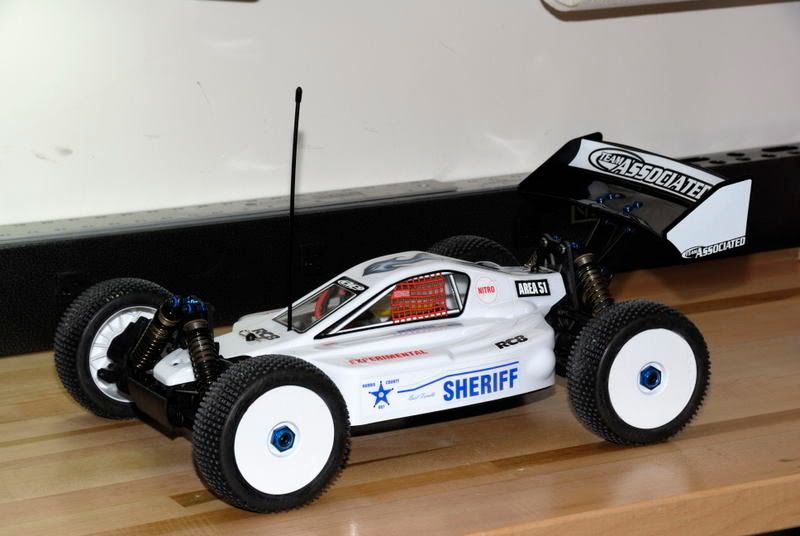

Here are some pics. It's in the experimental stage right now. It's a lot faster then the gas cars. The control is not as good as the gas car yet, but it's a lot of fun.:) It takes a lot of trial and err to set the speed controler for your application.
It's the exact weight and ballance as the RC8 gas car full with fuel. 3750g . I raced it for the first time last night. I finished mid pack.

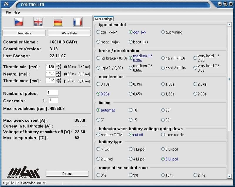

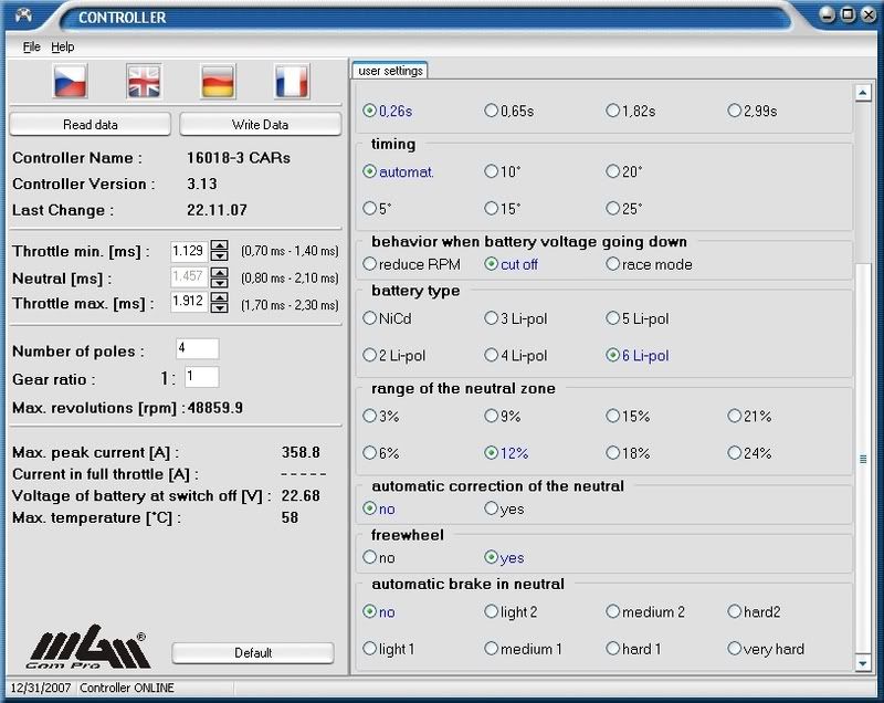

I think I figured it out!
The speed controler is not easy to program. I have attaced my settings. This is going to very depending on your setup.
It's working awesome! I can't wait untill the next race.

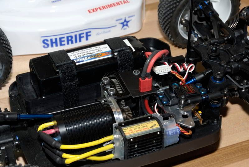

Specs:
MaxAmps 4000mah 6s 22.2v = My run time is about 25min.
RC-Monster Electric motor mount
RC-Monster Battery tray
Motor = NEU 1512 2.5df
RC-Monster Pinion = size - mod1 -5mm : 16 tooth hardened steel / with 46 tooth ??? still working on getting the right gear but it's good.
Speed Control= MGM TMM160183sHCS01
Home made speed controler bracket. I use alumm. angle.
