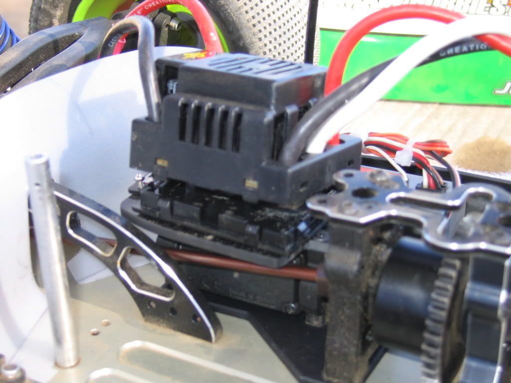

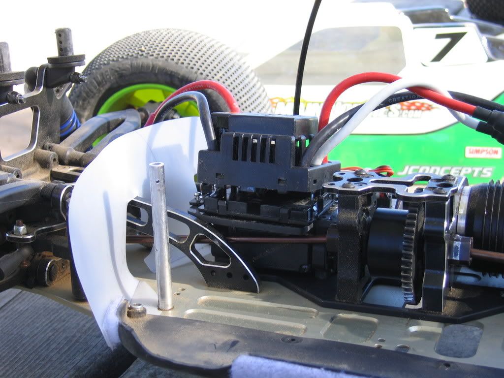

Well, I got my MMM from Mike yesterday and got right to work. First I had to build a platform for the MMM and I did that out of CF as shown in the first pictures. Then soldered everything together before heading to the track - here's what it looked like:

So, after getting it all set up and programmed - we went to the track to test it out. The results were excellent. I'm running a 6s NeuEnergy pack and a Neu 1515 1100kv motor and it ran perfectly. My gearing doesn't allow for the 40mph speed I was after, but it got up to about 35 or so on the track. Still pretty good and easy to fix.
Now for the downside. After a few crashes here and there we heard something loose inside. Here's what we saw when we pulled it off the track:
I put it back together and even put a couple spots of super glue on it, but it kept happening. Last night I took it out and did a full bead of super glue around the contact points so I think it will work fine now - we'll see. Just something for you all to be aware of in your planning.

Your truck looks nice. A lot of people complain about ESC being in a bag and all, but sometimes it makes sense. I would've thought Castle would also secure it with screws so situations like this won't happen. When you run it again, wrap some electrical tape where the 2 halves of the case meet. A zip tie or Velcro would also work if you can get it under the ESC tray you have there.

And about the electrical tape or velcro, actually the base tray of the esc stayed put. It was the separation of the MMM casing that was the problem. Hopefully my superglue job on the casing last night will take care of it.

Looks great! Glad to hear it is running well. If it continues to separate wrap a zip tie around it, it will not come off again.
If you look closely at this picture you can see the black zip tie I put around mine.

Why did you take the labels off? There are 8 snaps, but the label helps keep everything together in hard impacts...

Hey Patrick! Well, the reason I took it off was because the adhesive on the sticker and the texture of the plastic casing were not a comfortable fit for me. The sticker comes off very easily and I didn't feel it would be a good contact surface for holding down my investment.
See, I was going to use servo tape on the bottom of the MMM casing to the CF tray I built. And when I investigated the sticker that wrapped the bottom of the casing it wasn't a really firm adhesive. A bond is only as good as the surface it's applied to, and it just wasn't comfortable for me.

Hmm, that's not good... those labels should bond REALLY well to the polycarbonite case. I'll have production check to make sure there isn't any release agent on the cases we have in stock.

Yeah, I peeled mine off very easily and it left no adhesive on the plastic. Wasn't strong at all. Otherwise I would have no problem keeping it on there. I was worried that in warm weather it would get even worse. Anyway, thanks for being accessible here Patrick!
