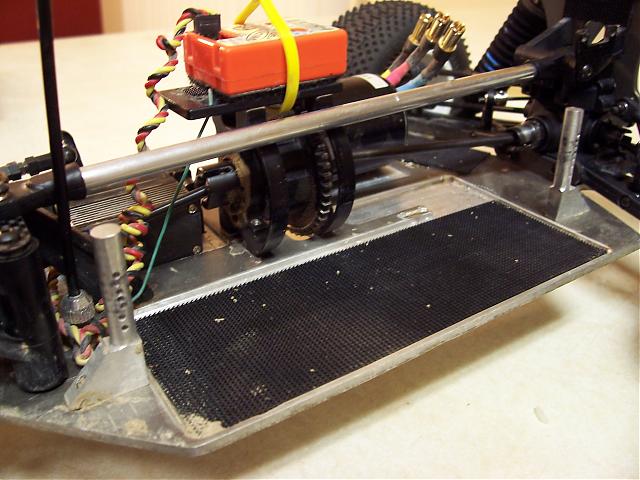

Nice chassis. Glad to see it put to good use. I like the aluminum work you have done on the towers. I thought I would post some pics of the battery posts and brace I recently made. I was having problems tacoing the front bone when I lawn dart into the back of a jump. I know they are not as finished as Blacked outs but I just don't have the patience to do all that finish work. By the way Blacked out, is there any news on the extra bones?
ID:	5749   Click image for larger version

Nice batt posts! You make some nice parts man! Is that all by hand also? And thanks
The car will look exelent when its done! Maybe I can hook you up with anodizing or something? Read your PM's
