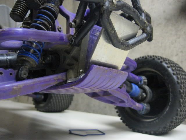

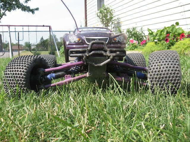

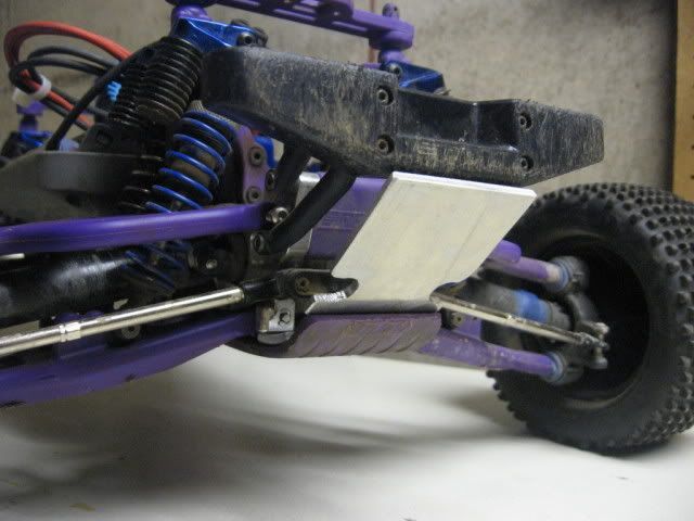

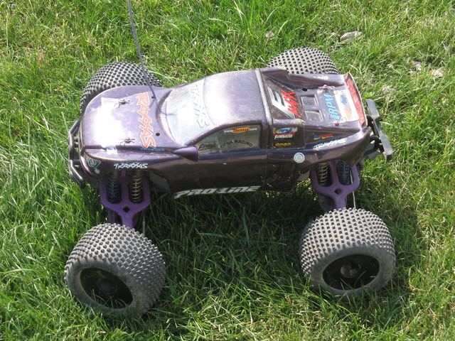

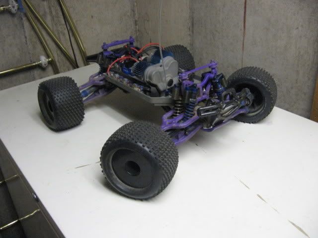

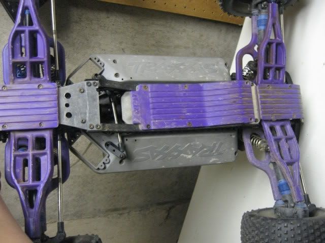

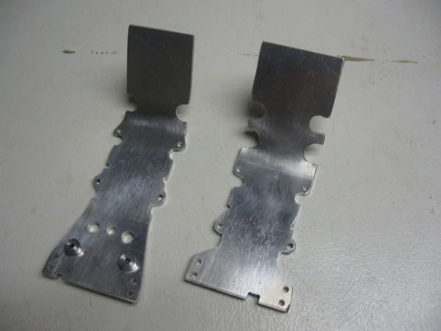

okay well i might as well post up my maxx
this is the maxx that its going into, the P-Maxx-
its got all purple RPM, skids, shock towers F/R, arms F/R, bulkhead brace, GH racing rear aluminum bulks, custom aluminum skids, RPM F/R bumpers, RPM Knuckles all around, integy piggy back shocks, Trinity XXtra firm springs, OFNA Mutilator tires/wheels, and i got a JR racing servo on the way, and im running 2 7cell maxamps 4700mah battts. thats the maxx thats this BL set up is going into. i have stock slipper set-up. -Wes
