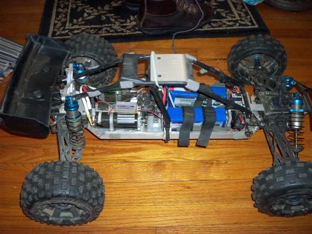

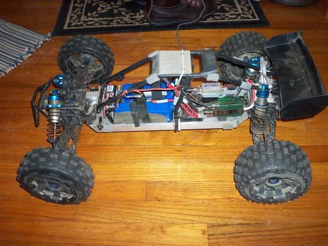

I had planned to make a buggy that used the XTM XLB buggy body. Would not be as long as the baja, but close. Was going to use muggy/lst parts, custom shock towers and a 4-6" wide al channel with 1.5" tall sides as the chassis. Narrow and strong. Planned to run a center diff/spool with a side or top mounted motor just like the rcm conversion parts for 1/8 buggies. Being long the motor and center drive could be closer to the rear and the batteries would be at the front. 4wd of course. Need to mock it up again so you can see what I am thinking...

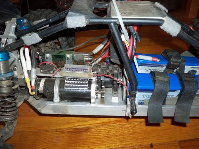

Kinda like this?

Got pics of how you mounted the rear of the Baja rollcage?
