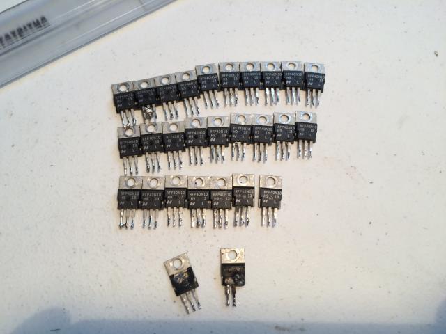

but here they are:
NEXT step - to Find replacement for 1998 FET - I selected IRFB4410ZPBF MOSFET N-Ch 100V 97A TO-220 -> close enough - better part - cost/availability - 28 fets

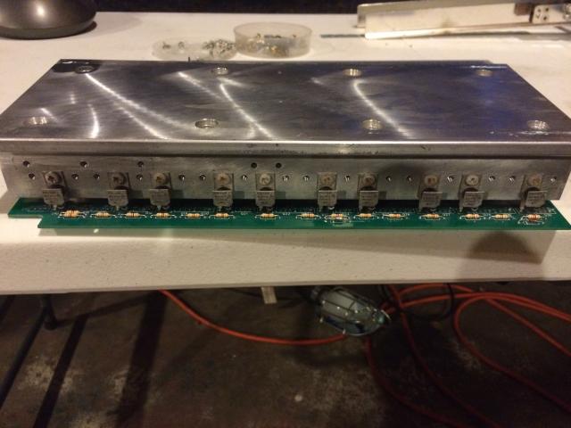

Check for spacing and preserve heat sensor...

You are correct about electrical contact, but they got it wrong from the beginning, given their heatsink configuration they could end up with FET's leaning away from heatsink if it was assembled not strait or due to heat expansion. They should use special clamps to keep FET's at contact and you can tell by the oxidation behind FET's and diodes tabs...
I think for 40A per FET (OEM) mounting screw was more than enough and use the rest for heatsinking or at least 1/3 by 2/3 - large area under die.
