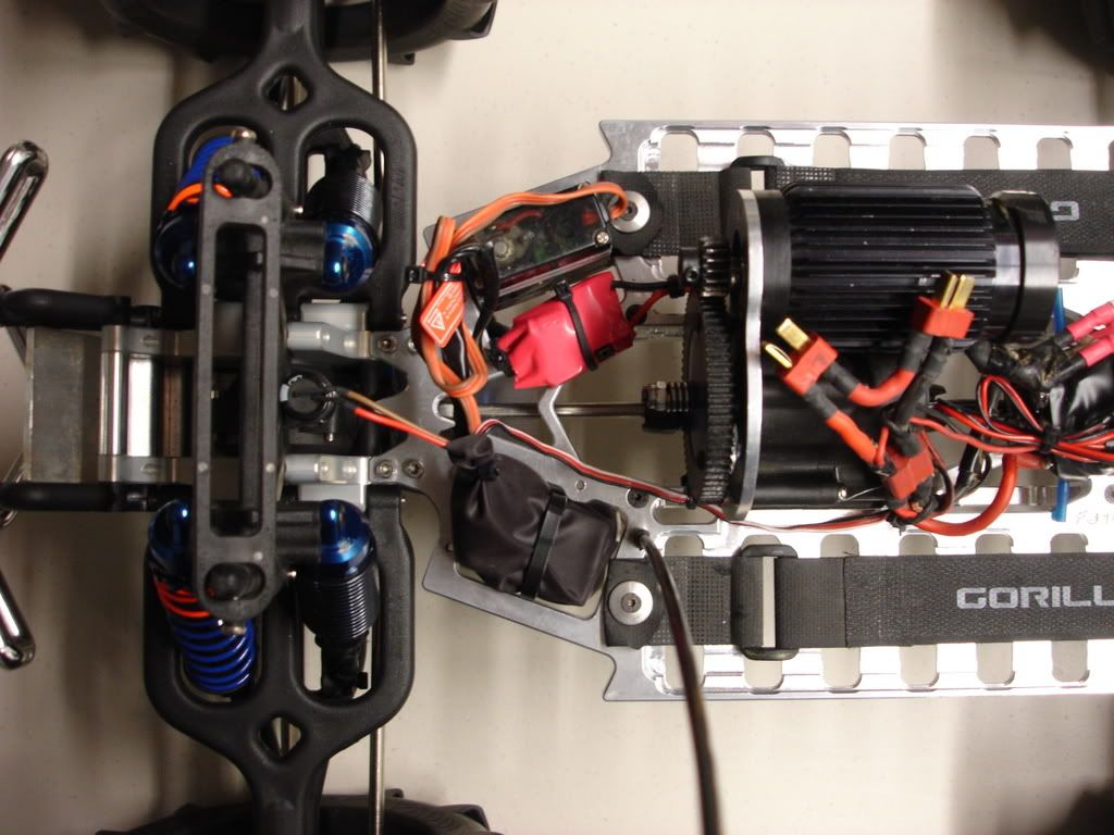

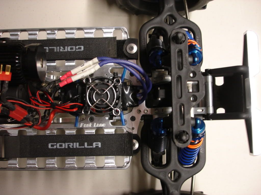

Here are some pics, let me know if you think I need to move anything.
Front, receiver and BEC
Back, motor and ESC

If the red thing between your servo and RX is your BEC, I would move it back to where your ESC is, switching are good but they can me quite noisy.

Hi, Try turning the UBEC over. With the board turned toward the motor and wires should block more interference.
