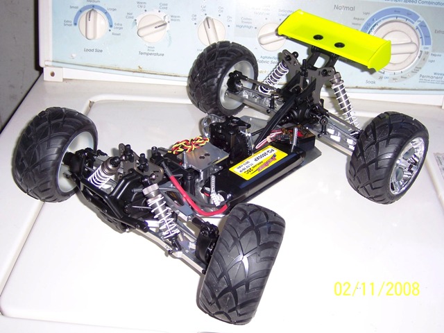

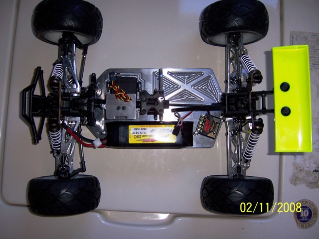

Here are a couple teaser pictures. The suspension and cvds should be ready in a couple weeks - pictures are the prototype. The suspension is .3" wider per side. The front upper arm uses a Revo rod end at the c-hub for additional strength (has a custom rod end insert). The total weight increase vs. the stock suspension is about 2-3 oz. total.
Enjoy. :)
