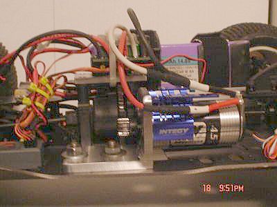

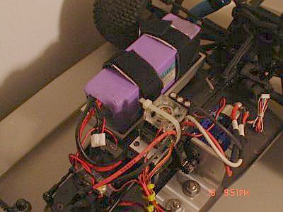

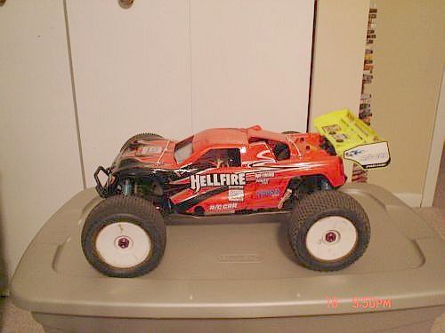

I just finished converting over to brushless.My setup is:
Mamba with fan
Novak HV 4.5
True rc 4s 8000mah
I made the conversion myself [battery tray,esc mount,motor mount]
On a 45 degree day after 15 min of running motor temps were 80 degrees and the esc was at 145, this is before I put the fan on.
