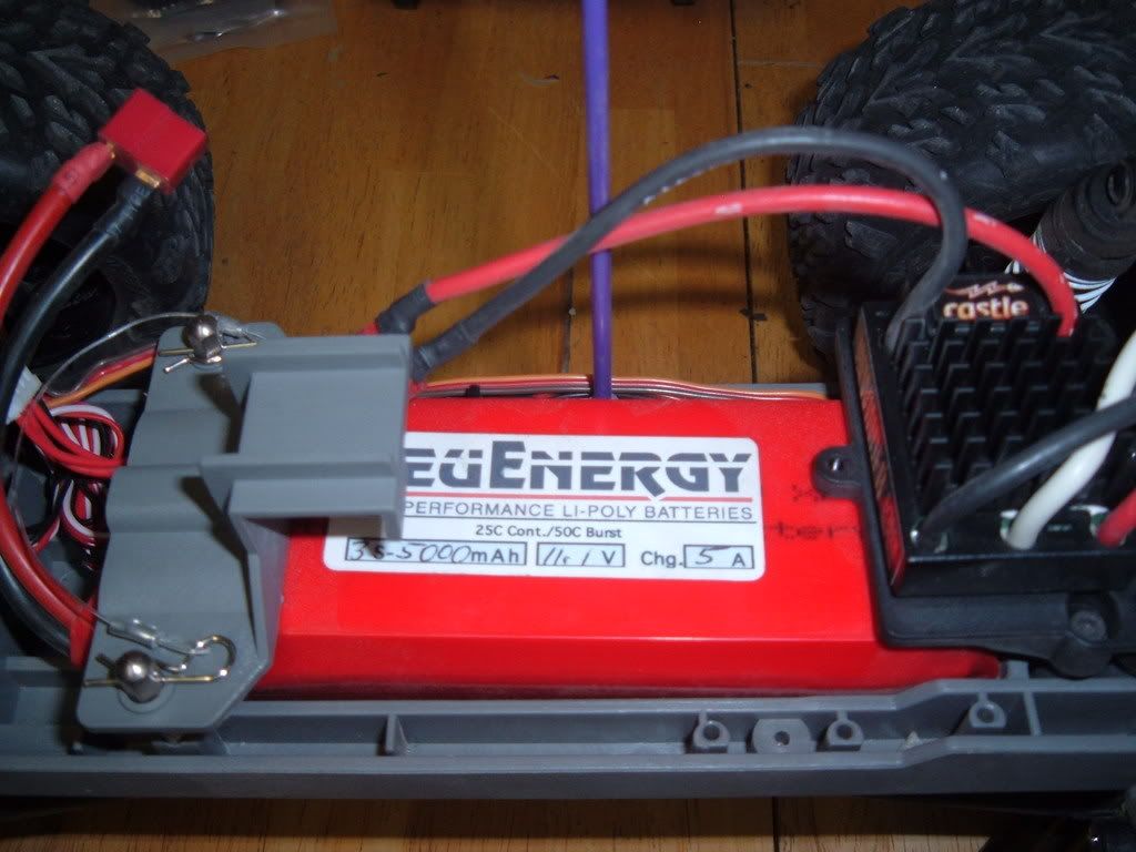

Anyways, I have done a few trades recently and ended up with a Pede vxl roller, neuenergy 5000 3s lipo and a Sidewinder esc. Figured that I would try out some of the unused motors in my "collection"! Going to stick with motors around 3500vk for this test.

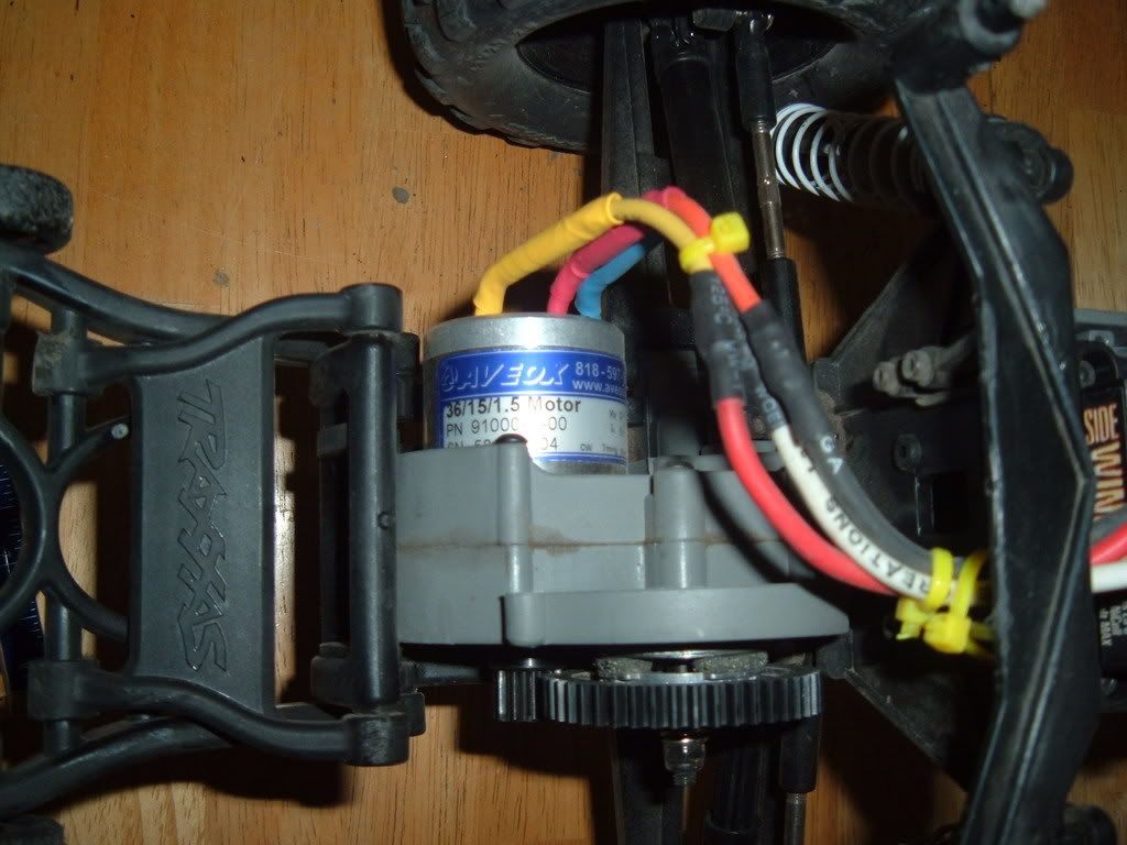

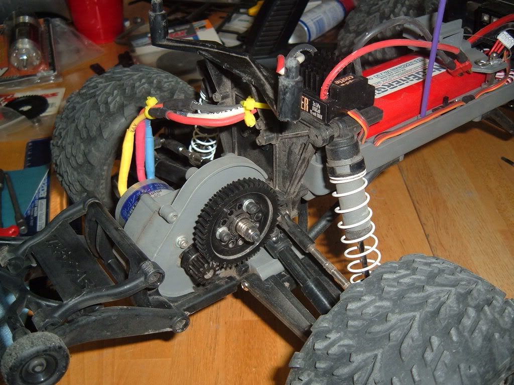

Next up was an Aveox 36/15/1.5. This motor is similar in size to a s can feigao, but most likely compares to a neu 1506 in power output. Kv is 3700 according to the sticker. It has a 5mm shaft, so I had to switch to mod 1 gearing, as I do not have the correct 32p pinions in 5mm bore. Gearing is 46/11, slightly higher than the previos gearing with the novak.
Plenty of power, in fact too much. I did not change the settings in the Sidewinder, and can say that they can be dropped down a bit. It does need some punch control, as any fast throttle causes massive wheelies and back flips. The truck easily gets up to speed, which must be near 45mph.
What suprised me was the startup. This motor is constructed like a neu motor. The little Sidewinder had no issues smoothly starting this motor from standstill, even with my foot in the way. It is actually smoother than some of my feigao/mm combos!
Temps were a bit warmer on the esc, but the power output is more so that was expected. I will tone down the timing and add some punch control and run a full pack thru it to see how the temps do.
I am very happy with this setup. It easily outperforms the baseline. Almost too powerful!

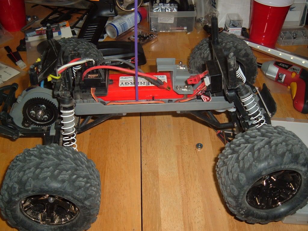

Heres a few pics:
