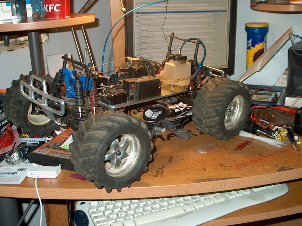

My ideas for the setup are:
this motor
http://www.hobbycity.com/hobbycity/s...idProduct=4570
this esc
http://www.hobbycity.com/hobbycity/s...idProduct=6550
with
http://www.hobbycity.com/hobbycity/s...idProduct=2169
http://www.hobbycity.com/hobbycity/s...idProduct=6320
and 2 of these, in series
http://www.hobbycity.com/hobbycity/s...idProduct=6428
What do you guys think?
Here's what I got when I plugged it all in:
Differential Ratio: 2.8461538461538463
Transmission Ratio: 1
Other Ratio: 1
Spur Tooth Count: 1
Pinion Tooth Count: 1
Total Voltage: 37
Motor KV: 215
Tire Diameter (inches): 6.5
Tire Ballooning (inches): 0
Motor Current Draw: 80
Motor coil Ω: 0
Spur/Pinion Ratio: 1 : 1
Total Ratio: 2.84615 : 1
Tire Circumference (inches): 20.42 inches (518.68 mm)
Total Motor Speed: 7955 RPM
Vehicle Speed: 54.05 mph (86.82 km/h)
Effective Speed Rate: 1.46 mph/V (2.35 kmh/V)
Estimated Adjusted Speed: 50 mph (81 km/h) - 7% loss
Effective KV Value: 215
Motor Torque: 2.62 ft-lbs
Final Torque: 7.46 ft-lbs
Final Power: 2960 watts (4 HP)

you won't like it with that ESC.. you won't be able to stop....
I would run a 20L, with the stock tranny... and 10S setup... it works great...

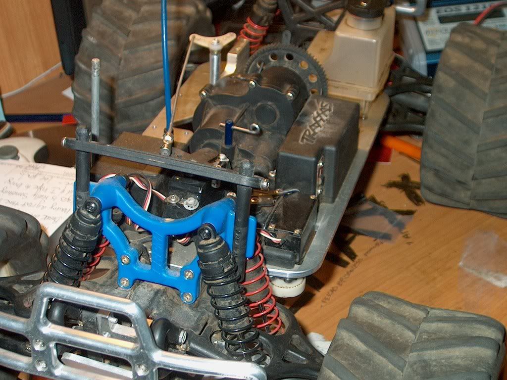

I figured I will get "creative" and figure out some way to hook up mechanical brakes. My idea was to have a brake disc with a 17mm hex, and bore out a metal 17mm hub, put that onto the end of the motor shaft, and then use the stock "pad and caliper" setup. I may do this with a 20 or 23mm hub also, depending on disc availability. As for a inrunner setup, where would I acquire a 20L Feigao? Where would I mount the batteries? I've realized that with Direct Drive, I cannot use that motor because the diameter, as it would make me completely remove the chassis braces. I have found this motor: http://www.hobbycity.com/hobbycity/s...idProduct=5204 which has a much smaller diameter, and would only require a small amount of milling to the chassis, and a bit of dremeling to the braces. Since the motor has 55 more kv, an 8s setup seems suitable. Any ideas or retort, Aqwut? I am still open to inrunner setups, but a shorter can motor with a very low kv would be hard to obtain, and it seems the batteries would have to be mounted on one side.

You could mount the batteries on both undersides of the maxx.. and on the right upperside as well... weight distribution is pretty good... that ESC should work because the 20L draws very little amperage... but it can pull more than 31 Amps... 31 maximum continuous...

the 20L is a small motor and draws very little amperage... on 10S and 31Amps, that's about 1100+ watts of power... That t-maxx is a light setup when ur finished, so she'll boogy very well...
