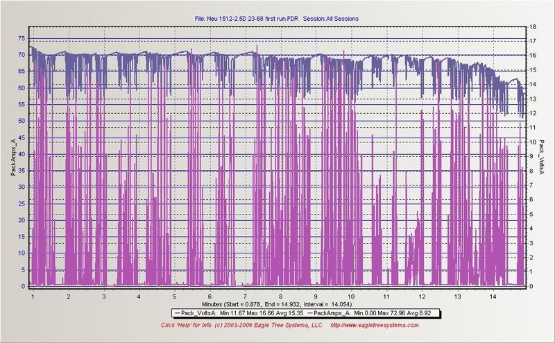

The E-maxx was on a Medusa 36-50-3300 but I just moved a Neu 1512/2.5D into it, amp draws are about the same for both motors geared for the same top speed(33mph) on 5s A123's. Here is an Eagle tree log from a run today with the Neu.
http://i287.photobucket.com/albums/l...irstrunFDR.jpg
