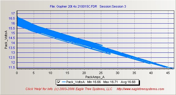

I'm just gonna start piling my own graphs in here for now. For ease of interpretation a voltage vs amperage graph is best.
Hyperion 16C 2100 4s pack. Didn't ever get above 100*f, maybe not warm enough to perform? Hitting 3v/cell at 38amps at one point. Third run on the packs I think. I am going to shorten the wires and see if I can get better readings, there is too much wire on the rig right now.

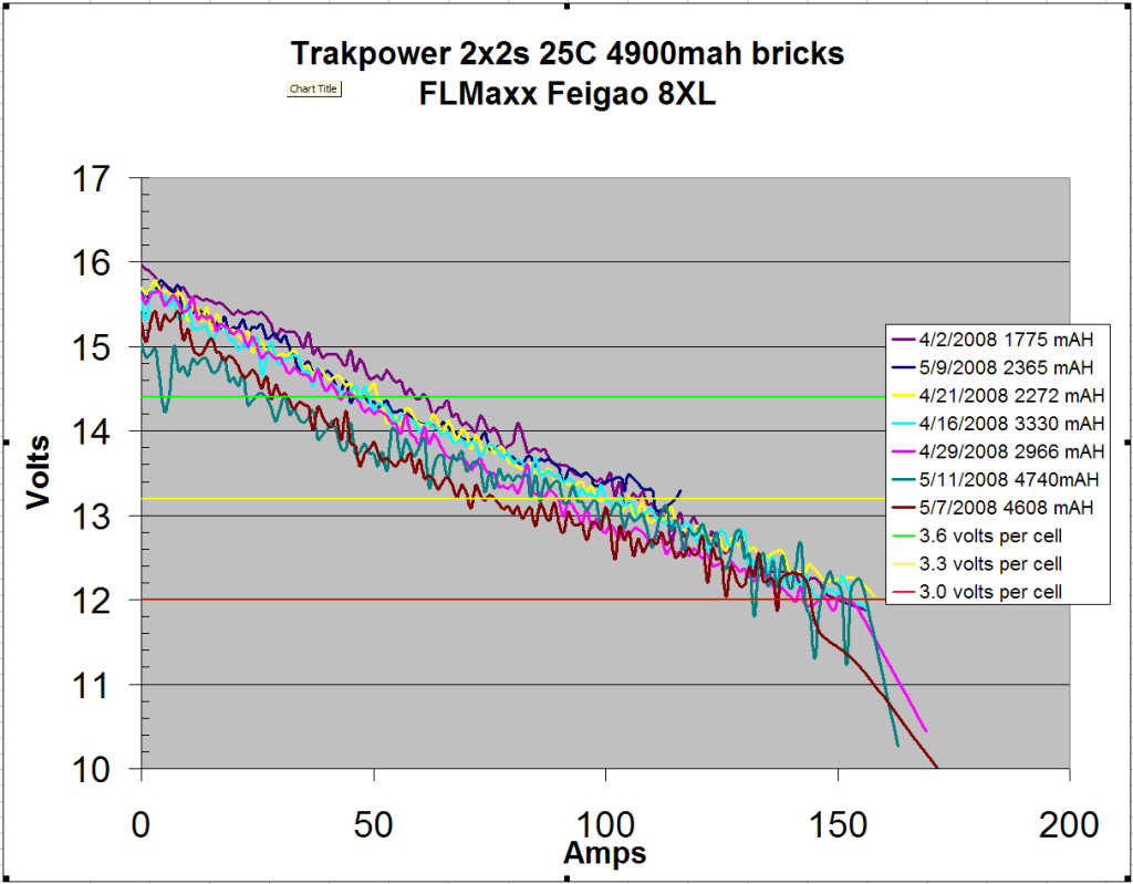

Here is a chart of a pair of 25C trakpower 2s 4900 bricks that I'm returning for exchange. Much to my surprise they don't even perform as well as my previous 20C packs.
Results are from eagletree logs then dumped to excel and averaged of the 7 runs following 3 initial runs for break in. Temps starting from 70-80f peak at 115f consistently after 2200mA discharge. Voltage drop reaches 3.0v per cell @ 30C. I'll post results from new packs after I get them for comparison.
