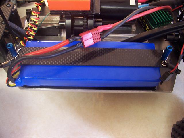

Thought I would post for your enjoyment. Suggestions, comments, and questions are welcome.
The rundown:
-custom cf batt tray and front top plate (I wanted to move the front brace out of the way of the driveline.
-custom fabricated 1/8in 7075-T6 aluminum chassis milled to reduce weight (I used the on campus shop at Utah State University where I attend school). The chassis was extended 14mm longer than the standard rc-monster chassis because I wanted to get closer to 1/10th scale hopefully Mike will soon get the extended a-arms done. I am also having Mike make me a custom extended bone for the rear.
-Jato body, this was my 1st attempt at doing multi colored scheme with the help of XXX masking (I know it bled in some spots. Now I know what to do better next time)

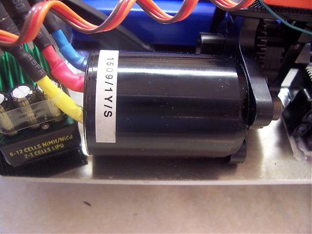

-And of course the neu 1509/1Y
Ren
