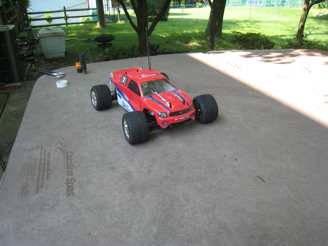

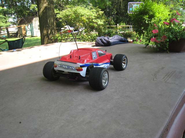

Here is a few pics
Highflier

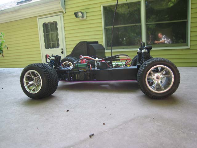

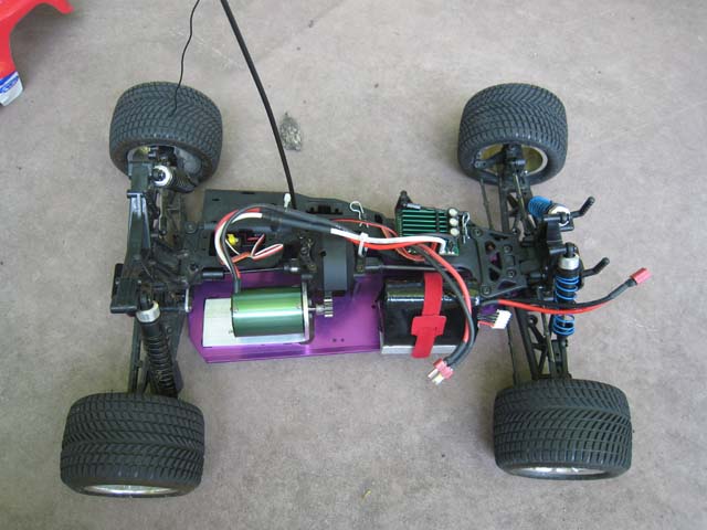

Oh I bet you wanted to see pics of the business parts :) Here ya go!! I was just teasing.
Highflier
