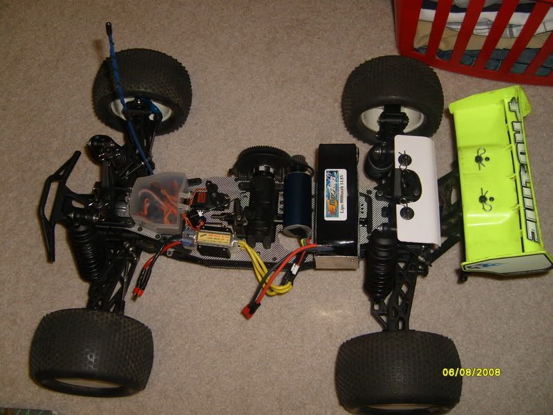

asianplayer
06.09.2008, 02:06 AM
ok heres a vid of what i mean, quality might not be the best but if you listen you can hear the motor spinning, and i havent even touched the throttle yet. Only after i tap the throttle do i get control back of the motor. I also added a pic of my truck, im still waiting on motor clamps.
