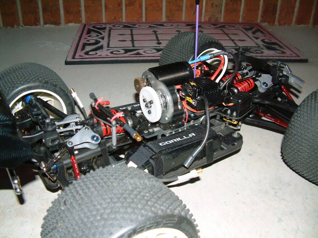

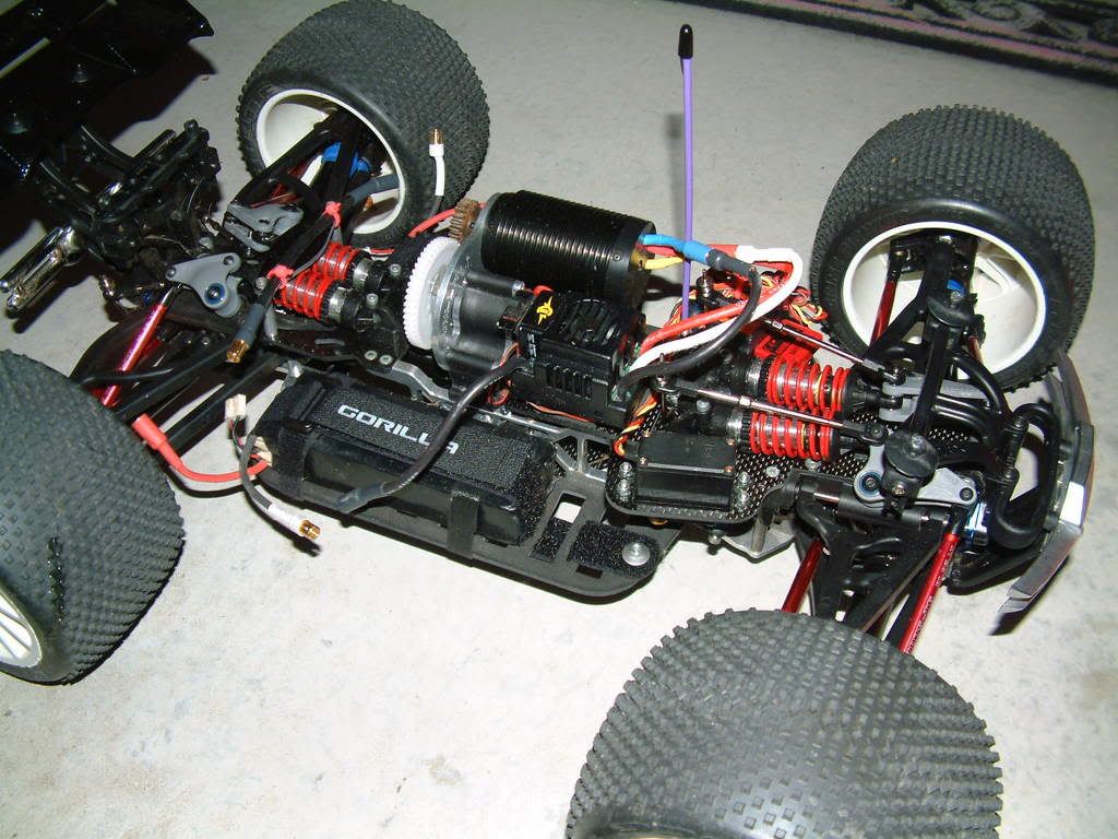

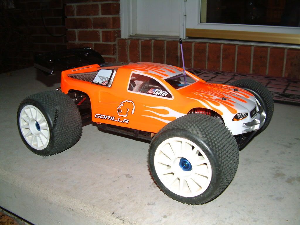

I've been reading a lot here and working on my G3R. I am setting it up to race in the MT class. I have finally finished the build and started testing. Thought I would post a couple of pics.

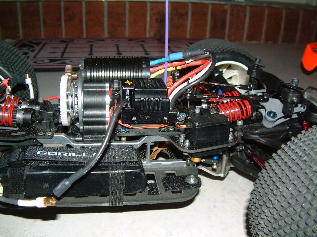

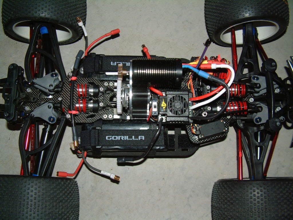

One thing I am testing that has worked well so far is a piece of foam rubber under the Castle Mamba Monster. It is about 1/2" thick and is normally used for rc aircraft receiver installs. The foam is somewhat stiff but still has enough compliance to give a little. I have a version 1 Monster and so far (knock repeatedly on wood) it has worked well. It also still has all of its fan blades.
I am using a Neu 1515 1Y/f, 2 MaxAmps 8000 mAh lipo's, the Castle Mamba Monster, and Spektrum.
So far I am having a blast with this machine.
Regards, Mark
