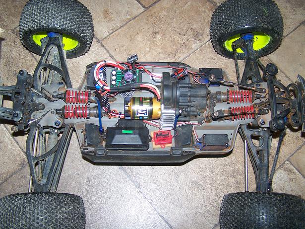

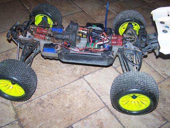

I just ran my revo for about 10 minutes keeping an eye on the temps.
I am running the 2826-8 axi outrunner motor on 2x2s 5000mah 20c packs,and a mm.
The motor got up to 180,and there is some cogging if i hit the brakes to turn and then hit the throttle without stopping,but I can work the throttle with no issue's as long as i don't hit the brakes.is there anything i can do to fix this or is it par for the course running an outrunner on the mm?
as long as i didn't use the brakes,i could accelerate hard multiple times and top speed runs,the motor run about 130.
Is it common for the motor to heat up using the brakes?
here are a couple pics.
I have the motor geared 22/40.the esc and batt's temp 100-110 degrees
