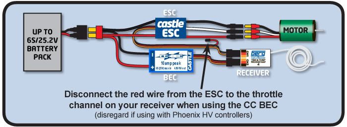

I have a MMM V2 that should be here soon. I also have a spankin new CCBEC sitting here as well. After hearing hints that some V1 failures came from the MMM internal bec, I thought this would be the safest bet. But now that the MMM has been revamped, is using the BEC warranted/needed/suggested?
Ideally, I would prefer to use the MMM the way it was designed...stand alone
...But I do have the BEC....
what would you do?

To run without significant load on the internal BEC you remove the +ve (red) wire from the ESC->Rx connector. This is the same connector you use to program the ESC with CastleLink.
I've always just assumed you need that +ve wire in place to program it, and always replace it before programming. I've never tried not doing it come to think of it - it could work.

to run a castle bec, you remove the red wire from the esc;

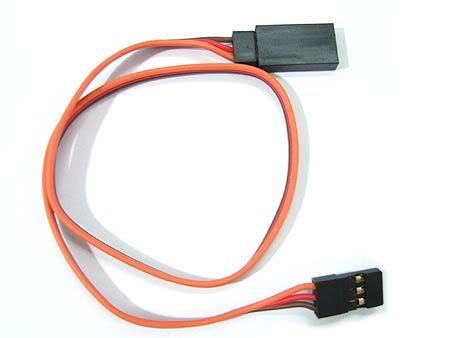

there is a simple solution tho. You buy one of these (servo extension wire) to run between the esc and the Rx;
cut the red wire on the servo extension.
when you need to reprogram, just unplug the esc from the extension, do whatcha gotta do, and put it back.

Yeah... and theres always that lol. Last time I tried that it wiggled itself free somehow and I lost control and nearly killed my car :( ever since then I like to use as few extensions as possible.
Thanks for the heads up on this! I'll use some elect tape or something to secure it.

Like hoovhartid posted buy yourself a servo extension lead and remove the red wire from this .
Then use the extension from you esc and reciever .
When it's time to programme remove the extension and you still have the red wire attached to your esc for programming .
