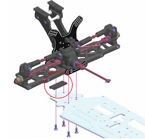

The front bumper is shortened from bottom and bolted straight to the original miniature bumper, upper part is attached to the front shock tower with zip ties atm (not seen on pics) - should really fix that...
Rear skid is shortened a lot and placed to the slot between the chassis & whole rear assembly where the original "bumper" was (see attachement).
Wheel arches are opened quite a bit, no rubbing in any wheel position when suspension is compressed equally - the chassis hits ground before.
