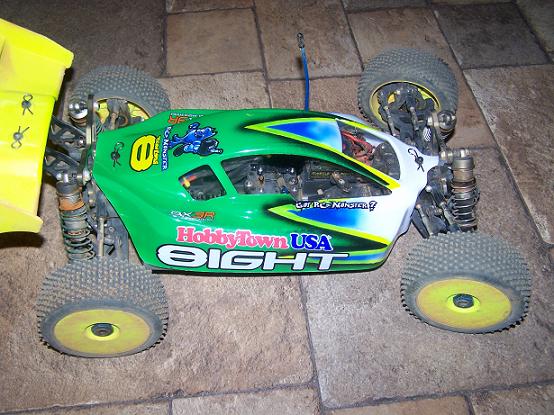

I came across a deal on a 8 and snatched it up,got a tekno conversion kit and ordered a neu 1512 2.5d from rc-m for it after the recomendation from members here
I am running a mm esc with a thunder power 5s 5000mah 25c pack with the mm cutoff custom 16v.
I have run a few packs through the buggy now,WOW is all I can say
This thing rips,it is a little too fast for me at 100% endpoint on the transmitter,just balloons the tires and wanders all over the track,I have found it drivable at 75% and still has the "nitro" speed down the straights.
I am getting right at 20mins runtime running it as hard as I can,Does this sound about right or should I be getting more.
The temps after the voltage cut is 150 motor,120 esc,120 batt's.
Geared 13-48.

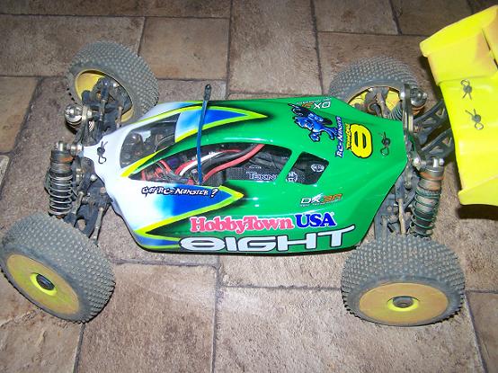

Here are some pics of the buggy still dirty from the track,and some of the body I just painted.
Thanks again for all the info,
Kevin

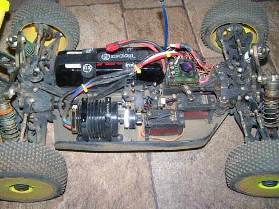

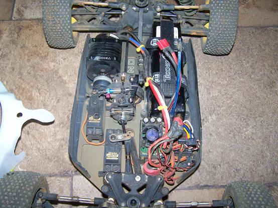

Looks great!!! That's good runtime too. It must be mighty fast since we usually run the 2.5D on 4s, LOL.
p.s. It looks like the motor plates under the motor mount may be in the reverse position. You can turn them around so the clutch assembly is better supported on the shaft.
