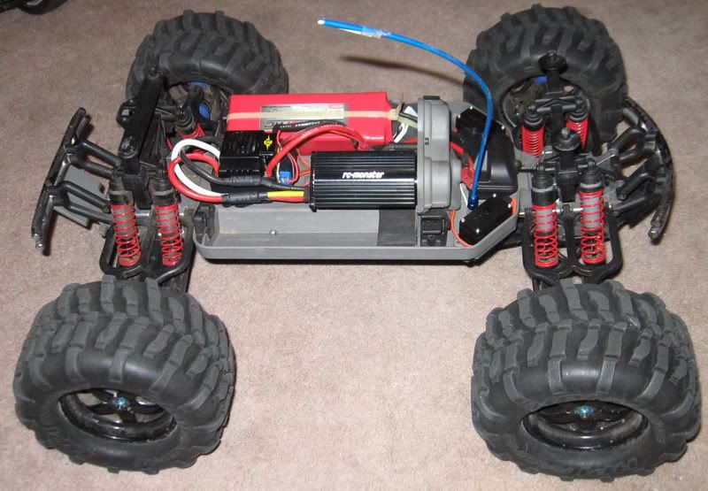

JerryF504
I don't understand, but I don't think I like it.
JerryF504's Avatar
Posts: 215
Location: Metairie, La.
08.11.2008, 09:15 AM
I need that. I run a 5s pack on one side so it jumps a little off sometimes. I wish someone would come out with an aluminium trans case for the 3905, so I could have some peace of mind.

Jerry do you have a picture with your setup with the 5s pack on one side? what motor and gearing you running with it?
JerryF504
JerryF504's Avatar
Posts: 215
08.11.2008, 09:42 AM
I have a pic on my other computer, I'll post it for you a little later. I'm running a Feigao 10XL right now with 20/58 gearing. I also have one of the Hobbycity 9XLs that runs surprisingly well on 5s but I mostly run the 10XL because sometimes I run 6s also.

Here is the pic of my E-Maxx with the 5s.

If the ESC is moved on to the battery tray, I can't imagine the weight balance being horribly off. And if you were to run a single servo on the motor/ESC side, that will help as well.
