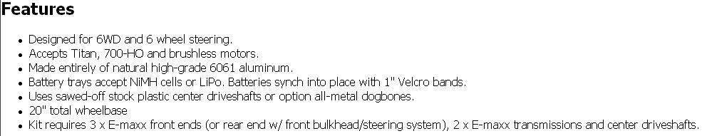

Found this while browsing on their site. Looks interesting...

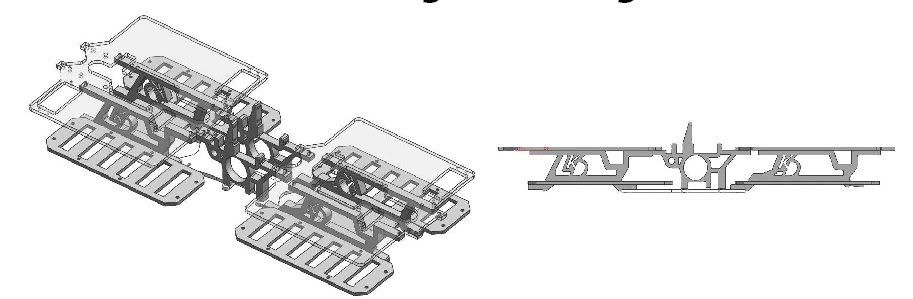

hmm dunno about the 6 wheels steering maybe leave the center wheels locked straight and have the front and rear wheels steer? i bet it would weigh 20 pounds easily

Dual trannies and 6W steering? Sounds like a nightmare to me, not to mention the large amount of batteries it will take. The center set of wheels would have to be stationary (no steering), just use the F/R to steer, otherwise steering would be difficult at best to do.
I've been wanting to do a rig style setup with dual drive wheels in the rear. Would be nice if someone would make a diff case where there was a spot for the pinion gear on the front and rear...

I think an six wheeler would be interesting with an articulated center to aid in steering. I do not like the kershaw design though. Come to think of it I don't like any of his designs. They seem to be hack jobs with minimal creative engineering or thought put into it.
