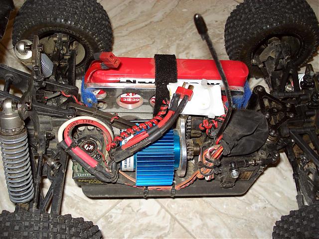

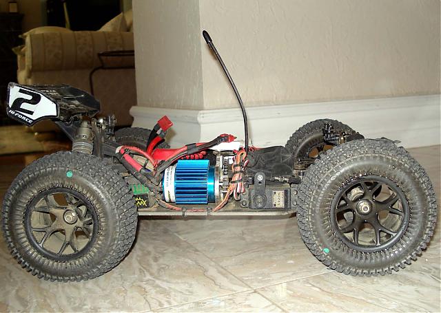

Hi guys, just thought I'd toss out some recent pics of my CRT.5. The original thread is lost in the Temp forums somewhere.

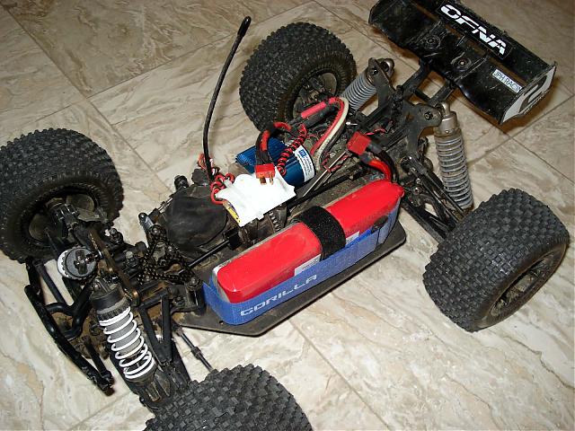

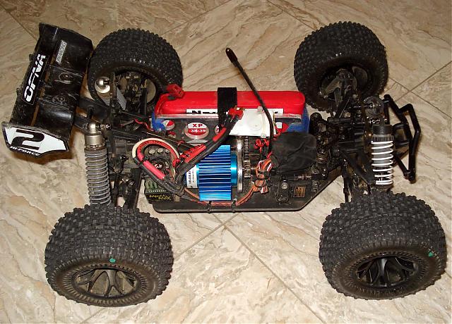

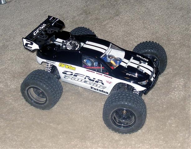

Time to dig this one out of the grave...
I did a little re-vamp on my crt.5 and changed up the motor, lipos, wheels/tires, and added in a koolflight ubec. I was running a Lehner Basic XL 4200 on 2s Neuenergy 5000's, and am now running a Medusa 36-50-3300 on 3s Neuenergy 3900's. After running this set-up for the past day, I'm very glad I switched over. The main goal was to get the amp draw (& heat) down, but in the process, I've also gained some more low end as well. Thanks again to mike for the motor and speedy shipping. Hope you enjoy.
