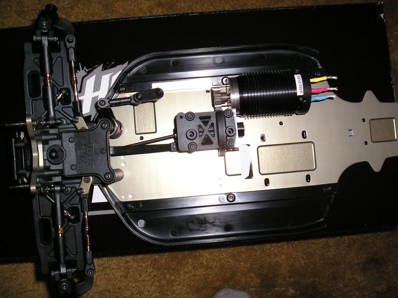

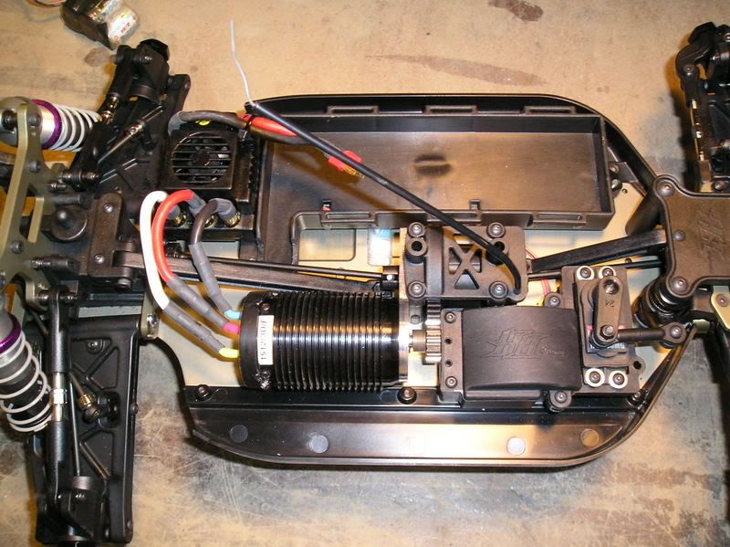

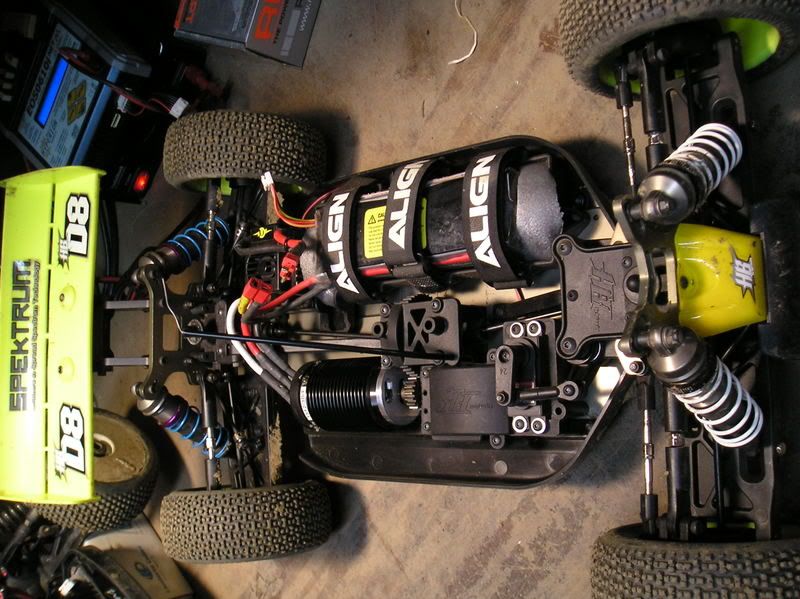

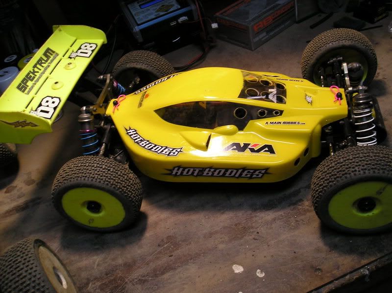

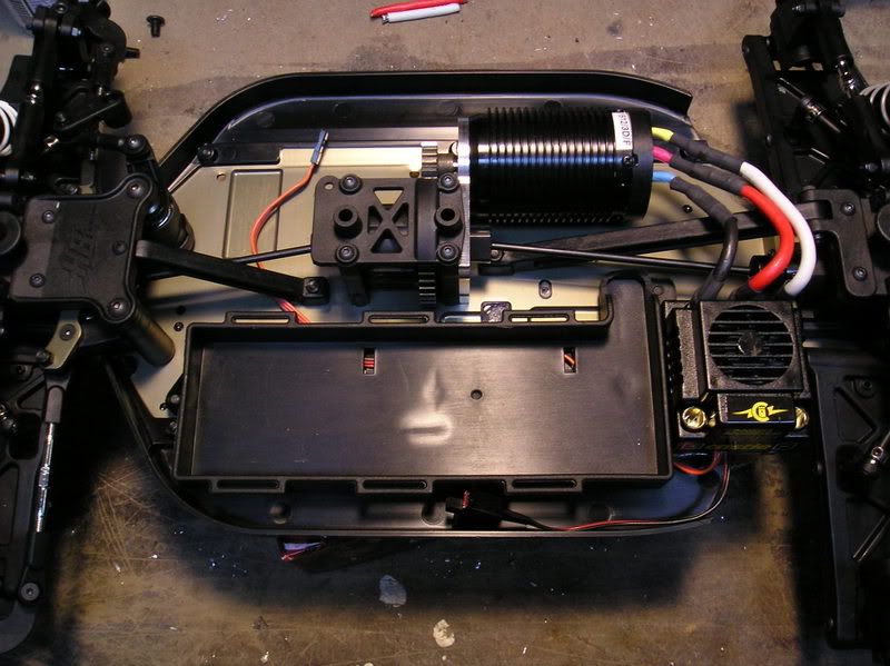

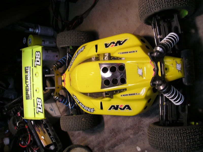

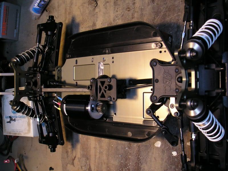

Hey All, I've run it a couple of days now & can say it is a great car to convert. Heres what it is:
-Neu 1512 3Df (1700Kv)
-Locally made Motor Mount (RCM style)
-Losi Conversion battery tray (modified)
-MMMv3
-5S Lipo (3300mAh)
-Kyosho 46t spur/ 17t pinion
-HB Longer rear shocks
http://i8.photobucket.com/albums/a43/RBMike/D8-01.jpg
http://i8.photobucket.com/albums/a43/RBMike/D8-02.jpg
http://i8.photobucket.com/albums/a43/RBMike/D8-03.jpg
http://i8.photobucket.com/albums/a43/RBMike/D8-04.jpg
http://i8.photobucket.com/albums/a43/RBMike/D8-05.jpg
http://i8.photobucket.com/albums/a43/RBMike/D8-06.jpg
http://i8.photobucket.com/albums/a43/RBMike/D8-07.jpg

11.30.2008, 10:26 PM
Blade98000: The car feels heavier on the track than my MBX6 but I have a 2000Kv motor in the X6 verses a 1700Kv in the D8. On the scale it's just 2 oz heavier than the X6. The D8 is VERY stable & handles great (I did add longer rear shocks). My X6 is great but the D8 is easier to drive fast (very forgiving). I don't own the Losi but I did drive a 2.0 (nitro) last week & felt it was a great improvement over the first version (which I have owned). The guy who's 2.0 I drove asked me today if I would put togeather a D8 conversion for him (he drove mine).

To get the Losi tray in I had to:
-cut about 1/4 inch off the back of the little platform that the ESC goes on.
-I slightly lengthened 2 of the motor mount holes in the chassis with the dremmal(slightly= less that 1mm)
-I drilled & counter sunk 1 additional hole in the chassis for the "middle" tray mounting hole.
The tray is secured buy 4 4mm flatheads from the bottom up (1 in front,1 in the middle & 2 in the back.
In order to make the body fit better I dremaled off 2mm from the bottom of each of the stand-off mounts on the bottom of the tray & filed down the top of the rear 2 mud guard mounting points. Body fits perfect with a 5S 3300 pack in it. The RX is in the battery box. Everything to the rear of the battery box was cut off of the radio tray leaving only the battery box & steering servo mount.

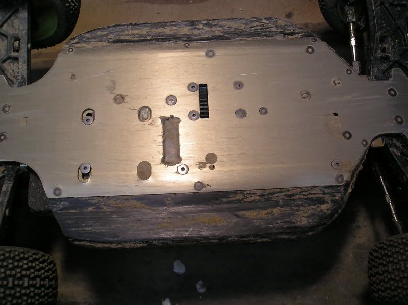

12.03.2008, 12:22 AM
Here is a pic of the bottom of the chassis. The 1 hole I drilled is the one in the lower center closest to the pluged flywheel hole.
http://i8.photobucket.com/albums/a43...e/D8bottom.jpg
I will also note that the Kyosho spur gear required me to modify the top plate and it was difficult to fit onto the D8's center diff cup.
