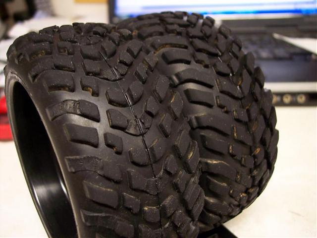

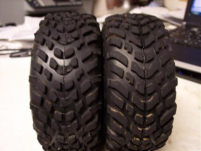

i think this helped alot the tire just feel ALOT softer i snipped half the big outter lugs off and the inside halfs of the big center lugs. the tire on the left is the grooved on obviously with the stock on the right. you can see now their are no big continous lugs to slide all over with, just lots of small lugs with room to get a bite....should work good, i never had much luck with other tires when having big gaps between the tread so thats why i left half of each lug i sniped and made it into smaller ones.

i tested the tires out yesterday afternoon, and it actually made a very noticable difference on my little track, dont get me wrong it still spun alot slid all over but it was much more controlable, i can pitch the truck into a slide and just hold around the turn, it spun out completely ALOT less, forward traction was still to be desired but it didnt pull hard to either side like the stock tires,
overall id say it is worth messing with, it only took me about an hour to do all 4 tires
