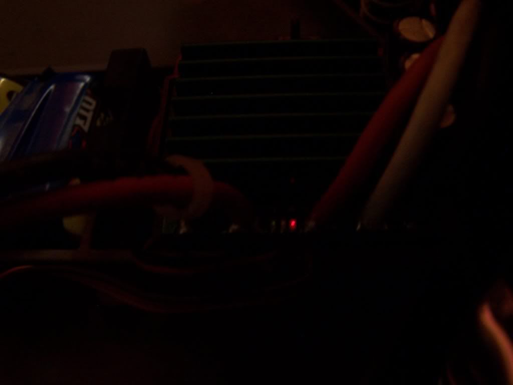

see this is what the esc does when i plug in a pack and turn it on.

ive tried 4 computers same result it progressively got worse till now nothing works
11.21.2008, 12:23 PM
You may have cooked the internal bec... Not sure if that can happen when running the usb cable with the battery plugged into the esc. The usb provides 5v to the esc brain for programming. You could try powering the esc with a rx pack, not sure if that will work.

11.21.2008, 12:41 PM
so does the red light mean i cooked the esc in general or what should be my next step what you see there is all the esc does when i have a pack hooked up.
