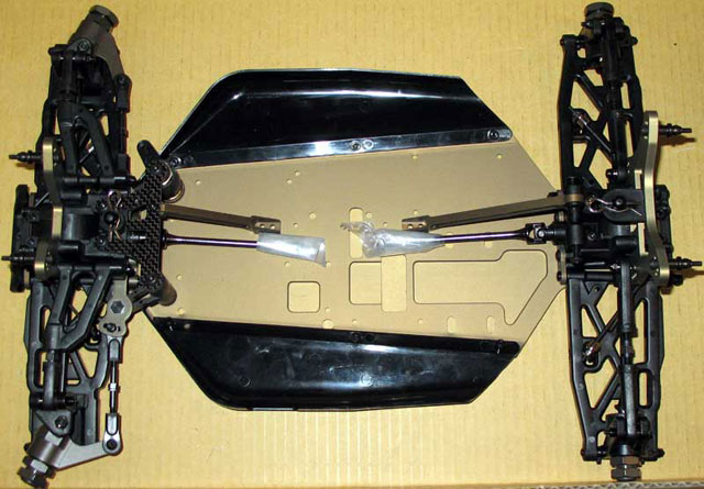

After building the rolling chassis I have looked at this from alot of angles. I have considered weight distribution, efficient and neat use of available chassis space, minimum running weight, optimal gear efficiency, gear tunability for track or straight line, and optimal motor RPM.

I need to up the spur to 56T because the Neu 1912 has a 1.96" case diameter. Although smaller gearing will produce adequate gear ratios, the motor case will touch the drive shafts with all but very tall gearing. My choice of large pinions has a desirable side effect: most gearing is cut with a pressure angle of 20 degrees (including the ones I'll use). At that pressure angle the minimum pinion you can (or should) run is 18T so as to avoid undercutting, wear, and noise.

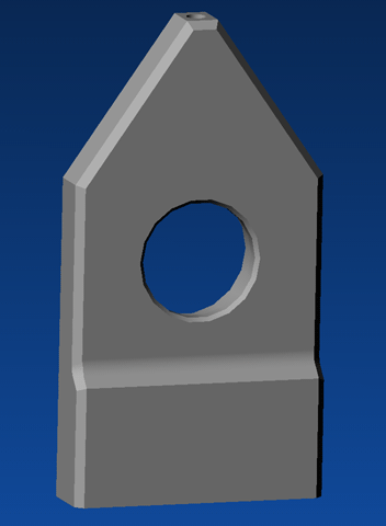

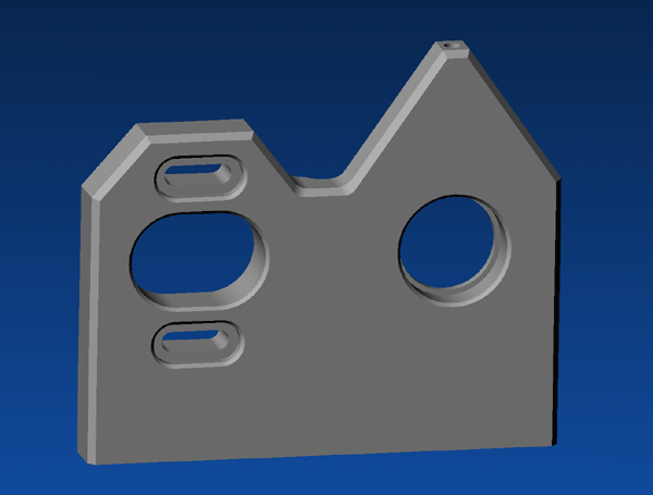

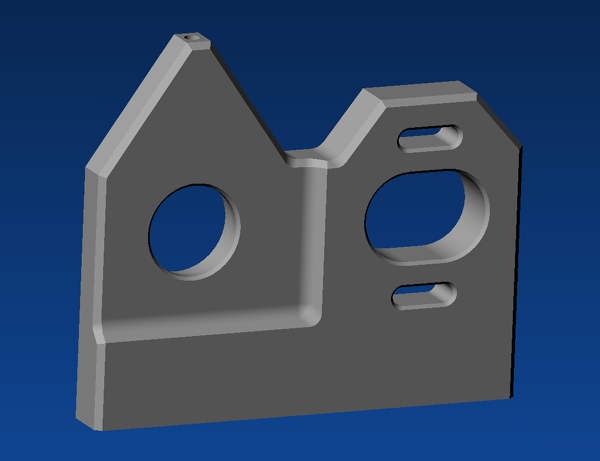

Well, I've attached a couple of diagrams for you to see. I've tried to design the motor mount in the hope of it being sufficiently strong and light weight at the same time (approx 60g). It is to be milled from a plate of 6061 60x70x9mm. The diff holder is a mirror of the motor mount without the motor section.

How many spurs you gonna have made and at what expense? Could you use much more widely available Ofna 51t spurs (and diff) With LSP r&p and large motor pinions? That should give you enough clearance as well as plentiful (and cheap) spur gear availability.

On the spurs, they will cost about $30. It becomes exhorbitant if they wear out or continuously strip, but assuming they have a long life it's not a big deal to cough up the extra cost. Given 7mm face contact width, acetal resin material, and hopefully no undercutting from the pinion, I am banking on them lasting a long time. If they don't I will need to rethink my design!! :)
I have considered the 51T Ofna spur. There are a couple troubles with it. First there are no published measurements of it regarding the spacing and size of its mounting holes and they're not a stock item in car hobby shops here for me to go look at. I plan to use the stock 48T spur as an adapter plate which leaves only a few mm of tolerance for drilling extra mounting holes without sacrificing strength - the 51T might be too small and too thin around its outside for mounting like this, and its small size would probably require me to machine away the teeth of the stock spur so that they don't get in the way - with a 56T spur I can leave them behind and just drill 4 mounting holes. At 51T my low speed gearing options will be limited until the motor case touches the drive shafts. It will also mean using smaller pinions which exceed a pressure angle of 20 degrees.
With my intended pinion range of 16-24T I can gear for 30MPH to 50MPH. With a 16T there will be about 3-4mm of clearance between the motor case and the drive shaft, which leaves me with some breath room to add a cap to the front of the motor to seal its big holes.
