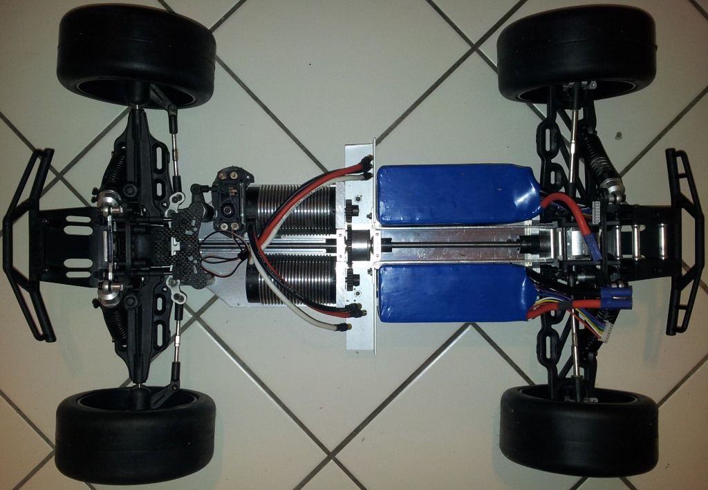

Hello everybody,
since I still wasn't satisfied with the performance of my 1717 powered Truggy I looked at different options on how to drastically increase power.
After ruling out 1/5 scale components and high voltages for several reasons (more expensive, not as reliable, bad weight distribution, 8mm mod1 pinions hard to get and pricey),
this is how far I've gotten until now:
Wheelbase is about 42cm, length from Bumper to bumper is about 62cm. The body will be a Associated Rival body. A wing is still missing, but I will probably fit one later.
Final weight will be around 7.5Kg, weight distribution front/rear will be about 49%/51%, left/right weight distribution will differ less than 0.5%.
Tires in the picture are belted FG 1/6 scale Buggy onroad slicks on Carson 1/6 scale Buggy rims. Diameter is about the same as Truggy wheels but they are a little narrower.
Chassis is constructed by bolting a cut TT MT4 G3 and a cut TT EB4 chassis together, this gives about 55mm more length to fit all the components.
The two Mamba Monster ESCs will sit on the middle section above the center diff and will be wired to two paralleled 6s 5000maH 40C lipos.
The angles that you see in the middle section are not cut to length yet, they will be connected to an undertray that will make the chassis about 15mm wider and will also form the sideguards.
Receiver and BEC will go in front of the left motor right next to the steering servo.
Front Diffbox is from a Inferno MP7.5, rear diffbox is GPM alloy for a Savage (to allow for CEN diffs). Bumpers are also from a Savage. The rest of the parts are from a TT ST-1 Pro.
Front/center/rear diffs are taken from a CEN Genesis GST 7.7, center dogbones are from FLMs extended Savage A-Arm kit, the cups on the pinion gears of the front/rear diffs are Nitro-Mods 56HRC originally made for the Savage.
Driveshafts to the wheels are stock, but with a Torx setscrew and high strength threadlock to stop the pins from coming lose.
I hope I can run 21/46 gearing which should give 100mph topspeed and wheelies at 60+ mph
