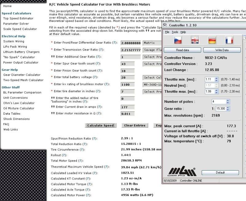

Finally converted my Sav XL to BL as planned. Went w/ my MGM 9032 and a 80mm Medusa 1100kv on 8S. Very nice power. I'll post pics in a thread when its totally done.
Anyway, went for the initial test run today. Just some not too heavy grass driving, and mostly parking lot runs. Plugged the MGM tonite to adj settings, and this is what the data recorder said. 177A!
That's almost 5 freaking HP on 8S.
Seemed like it had quite a bit of power, but I still have the stock big balloon tires on, and I could barely get any spd out of it before it wanted to wobble out of control. I only geared it for 40mph.
I have an ET, but I cannot locate the data cable, so I can't confirm with something else. Altho it was 95F today, both the motor and the esc were @ 130F+. When I had my Revo on 8S, everything was dead cold. Not nearly the level of power I have now tho. Wondering if the esc can read burst currents better than the ET can, or is this just way out of line? OTOH, I can't figure out what some of the other stuff is, such as the max revs output. WTF.

6.6hp! damn that is nice, with my 2650kv in 4s , i am getting about 5-6hp.
08.19.2009, 12:49 AM
Don't forget, those peak numbers are just that; peaks. Normal running will be far lower. A gradual trigger finger will help reduce those currents.
As far as the ET is concerned, it samples every 1/10 sec, so if a burst happens in between samples, you won't catch it, or will catch the rising or falling slope of the spike.

Are you running the MGM "black box"? If not, those figures are way off, Mgm say to use for comparison only as it is not accurate. Heck, I get 400 - 500 amps with my 2.5D on 6s.
Edit: Saw the model number of controller in the original post, so no that is not accurate.

Yeah, I am well aware of that. I've just never seen a burst that high. I do know that the castle guys were talking about having equipment that could catch data at even a finer resolution, and they could see extremely high currents.
This just makes we wonder how sensitive the data capture on the esc is (rather than some artifact.) I really need to get the ET up and running and do some comparisons.
hmmm... disappointing and comforting at the same time.
The figures are impressive, but seems way high. I was aiming for ~2000W on the bursts, but I could see hitting 2500W or so. 5K is just way crazy for a truck doing 40 odd mph (it is a hvy bitch tho.)

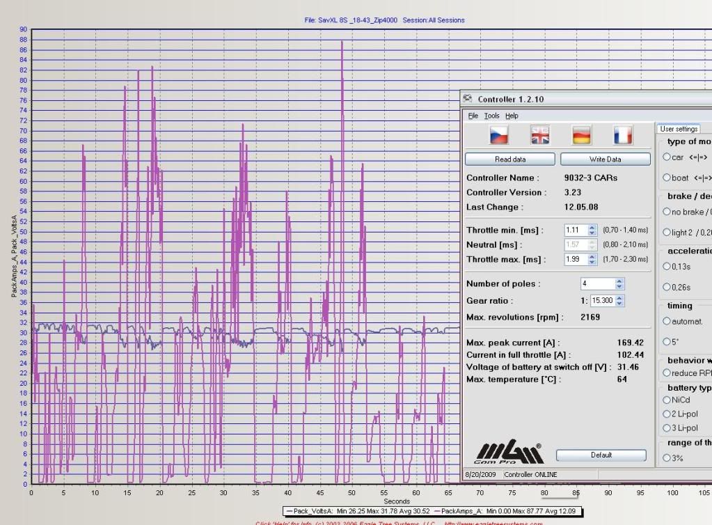

So I found my ET data cable and ran it a bit. The batts were not fully charged, but it was far closer to what I was planning.
Overall a ~90A/2500W system. If I go upto 10S, it puts me over 3000W.
To be fair I should read the esc again and see what it says.
EDIT: I DL'd from the ESC, and I'm not so sure its so far off. The max current is high, but the current at WOT is only 102A. That's not that far off from the ET data @ 90A (who knows how accurate that really is), plus the ET is only set for 8Hz. It could cert miss a micro burst or top of a peak. Notice how close the voltages are, and I know the voltage on the ET is right as I spent quite a bit of time calibrating it. The temp readings are also close to what I saw.
