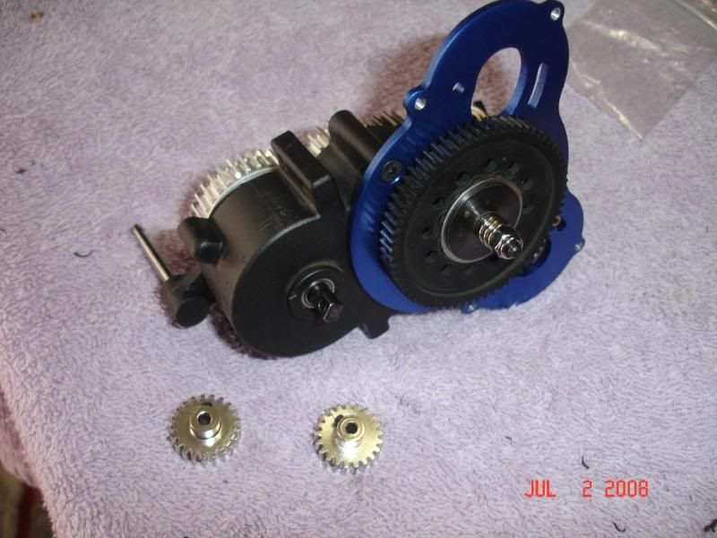

Actually its a t-maxx. My old s-maxx is getting tired of being nitro and i want to covert it to brushless. I've considered either just putting a new e-maxx transmission in it or using rc4wd's HD R2 trans. They said it can take that much power. The gear ratio has me confused. Their site says it can use a 10:1 to a 30:1 ratio. Whats the trans ratio for the new e-maxx. Nevertheless, if i did use this trans i would make my own moutings so i know that. What are your thoughts on this idea?? Also, can someone tell me if the all metal gear set for e-maxx trans on rc4wd's site is for the old or new e-maxx?? If they were for the new one, i would consider using them to beef up an e-maxx trans instead.

The smaxx will not easily fit the new emaxx tranny. To do so you would need the new emaxx chassis, trans and center driveshafts. You can put an old emaxx tranny in there, but they are not the best stock, need steel idlers an the gmaxx single speed kit is good too but costs 70 bucks...
Thr stock ratio for the new tranny is 1.83:1 so the r2 tranny would be way low geared, so your truck would not go very fast. I would stick to the emaxx tranny if I were you.

The tranny gears on the 2nd link is for the old emaxx(3906). I have a brand new set as spare in case my single conversion goes bad. The gears are made from 6061 aluminum.

Is indeed. If you beef up the gears, and tweak the slipper, its fine. The R2 tranny is for rockcrawling, very low gearing- I havent heard too many good things about the quality of the gears in those crawler trannies either.
Best to stick to the Emaxx trannies if you are wanting to do a straightforward conversion like that- the new emaxx tranny is beefy as standard, and shouldnt be too hard to mount.

I have 6 sets of their EMaxx tranny gears and they seem to hold up pretty well. I also have the steel idler gears installed in all of my tranny's for added strength. Hay Lito your PM box is full. I was trying to send you a thank you for a heads up.
