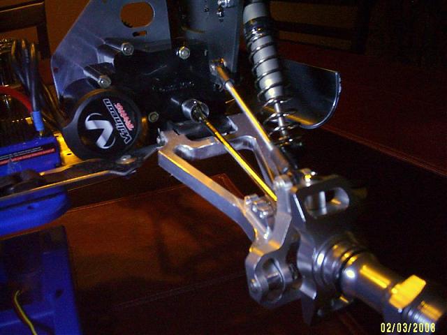

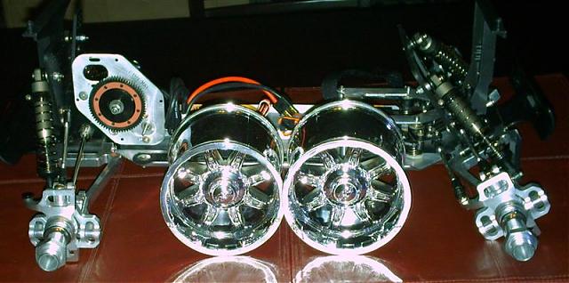

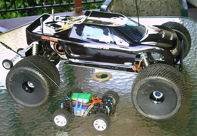

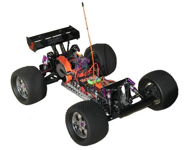

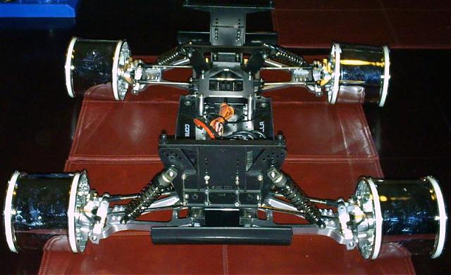

MRC Electric Thunder King. Built in 1991. World Scale (1/8+). Awaiting parts to complete project. I have one vlx system installed, awaiting the 2nd system. Rebuilt stock aluminum shocks and polished all stock aluminum chassis parts.Will be removing stock body post towers and replacing with aluminum extended body posts. Final weight will be in the upper 10lb range with dual lipo. Here is a partial list of componenets:
Dual VXL 3500kv motor and esc's
Dual 208oz TowerPro MG995's - Traxxas Servo Connector Y Adapter
HPI Savage aluminum suspension arms- front and back - Savage X Axles, Wheel Output Hub Shafts
HPI Savage Aluminum C-Hub Steering Block
HPI Savage Silver Extended 23mm Hex Wheel Adapter Set
XTM Mammoth real axle dogbones 138.6mm
RC4WD All Steel Gears
40 Series 23MM Cheyenne Chrome Wheels
Pro-Line/Proline Masher 40 Series Tires
Deans 12 Gauge Wet Noodle Wire Set
Spektrum DX3.0 DSM Radio w/ 1 SR3000 Rx
2 - 3S/6350 ZIPPY-H 5000mAh 3S1P 20-30C Lipos
Dual Gorilla Battery Straps

Thanks for the positive comments. Still have some work to do but the build went fairly fast. I like the stock shocks as they are very beefy and in new condition. I used associated 40w fluid. I will try them out and see how it goes. Team3six. One of the things I changed about my build is not using an elevated deck for the electronics as I wanted a lower center of gravity. I also used xtm mammoth rear dogbones as they are much stronger than grafting the two halves together. I should be receiving the 2nd vxl motor and esc in a day or two. I will post performance numbers once everything is sorted out. Thanks once again.

I know those shocks are beefy, but they are really bad. They wont hold up and the seals will take a dump on you. I say this because if your going to do that thing up right you dont want the bottom scraping its way and then you end up stripping a gear, folding an A Arm, or something else. remember my friend the MRC is not in supply of consistant parts availablity. And for the price of the shocks I mentioned to you. A set of 4 cost less then a set of 8 maxx shocks. Been using them for years and I will vouch for their stability. realize that I have been building and designing RC's for years so I do have alot of experiance in this. I cant say that money is a big problem for you since you are spending money on the other parts. On that dog bone, Well im going to have to check that out, I never really tied it. Mine is already titanium bones, they just braised them together at a machine shop using a plasma torch. Its pretty strong. I can bend them at all. But it's nmice to know there is another oppertunity out there. As far as the upper deck. Well the reason for that is because of the center of gravity. You know there was alreasy a mount for a single battey of that truck to begin with. if you removed that and the other end that held the mechanicle speedo, then you have now room to place 2 batteries side by side. They will weigh more than the ESC and the reciever combined even if they are lipo's and placed like that will leave no room for the speed control or reciever to sit. You dont even have to make a full deck like I did, there is another reason for the deck then just to place the controls. it acts like a control rod, keeps the truck from twisting too much upon impact with the ground. The stronger you make your chassis, the better the control. If you ever look at most 1/8th RC's you will notice they all have that feature. 4WD's have the bar for protection as well as stability. So though I like what your doing, I assure you I have been there done that for 5 years now.
Not trying to change your mind, just trying to insure that not only can you run that with todays equiptment, but that you can continue to run it and not have to find away to manufacture a part or have one made for you.

Thanks for the input. My first MRC was the MT-10S I purchased about 12 years ago. It's gone through several transformations. It now houses a 13 turn motor with a super rooster esc. Chasis has been stretched 2" and has a Proline Hummer body. The chasis on th TK is roomy enough to hold 2-5000mah lipos, 2 esc's, 2 vxl motors and receiver with out problems. I will look into upgrading to some big bore shocks. I prefer not using piggy back style shocks. These TK's are very simple in design. Super easy for anyone interested to upgrade and modernize. I usually work with 1/8 nitros which are more complex. This project is just a basher as I do not race. There are hardly any tracks in socal. I prefer to complete my projects in a week or two. I am a type A. Once I get started I don't like to stop. :)

Update: After replacing a broken bulkhead, I decided to lighten up the MRC by replacing the aluminum arms with RPM plastics. I also replaced the castor and knuckles with plastic. I also switched to a lighter wheel and tire (road rages) combo. In all I save about 470 grams. I have 2 new controllers on the way to allow me to run on dual 4S with the velineon motors and some new energy 4100mah 4S lipos. My setup is down to 10.5lbs (4762g).
