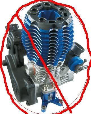

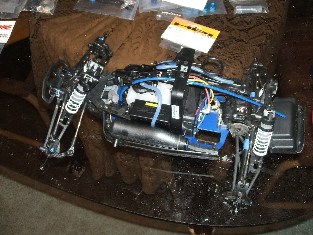

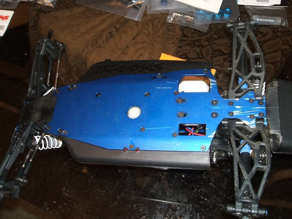

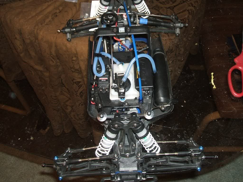

Wasn't sure what I was going to do with the 3.3 motor I took ouit of the SLayer. But I did miss the Jato after I traded it. So I picked up a roller of ebay. Looks pretty clean wasn't a bad price either. Now I got till spring to get it ready to go. Read an article where they made the Jato a remote start with their 3rd channel. Thought that was pretty cool so I am going to give it a go.
Ooops, haven't finished with the pictures yet. Will add a couple sd soon as I resize them and what not.
