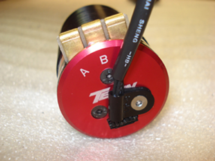

My combo did not come with the silver screw to mount the sensor wire holder. My question is to mount this holder I assume you have to take one of the black screws out of the back of the motor? Can someone tell me what size this screw is, I would hate for my sensor to come unplugged off the motor. Thanks

Sensor cable tie down screw that should have been included is 3mm x 10mm flat heat.
Should also have received 4/40 x 1/4" pan head for mounting the speedo. These cannot be longer or they will screw into the pcb.

Obviously you have to take out one of the black screws out of the back of the motor, correct?

Yes you replace the original screw with the longer screw.
Name:	T8 cable tie sm.jpg
