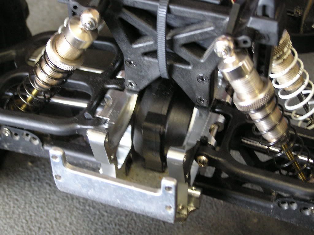

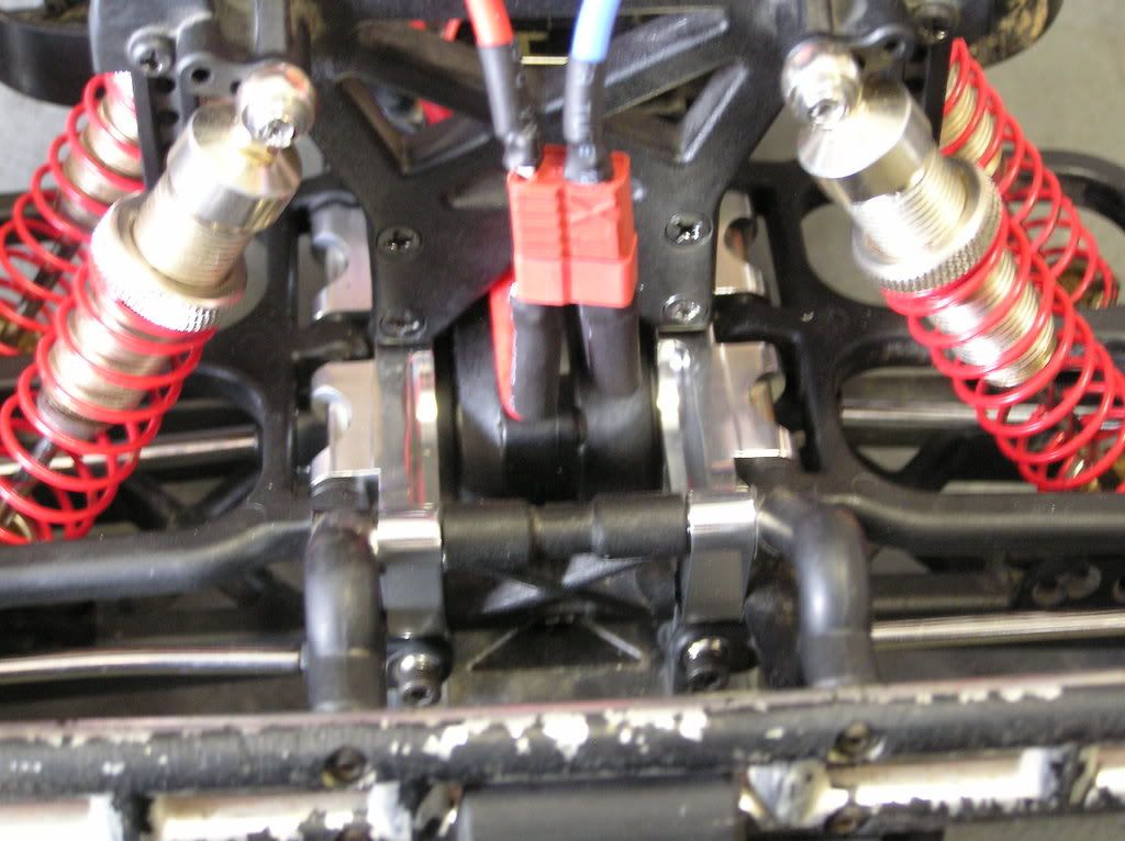

Hey guys! I thought I would share my E-Maxx with you guys. Tomorrow is my b-day, but I guess it came a day early. Here's what showed up:
MMM 2200kv combo
Aluminum bulks
3905 diffs
CVD's
I put it all in and wow this thing is a beast! It has all the torque in the world geared 18/64. I also have a 3s on order so I can run 5s lipo. Here are a couple of pics:
Front end-http://i368.photobucket.com/albums/o...3/P1010160.jpg
Rear end-http://i368.photobucket.com/albums/o...3/P1010163.jpg
Chassis lay out-http://i368.photobucket.com/albums/o...3/P1010162.jpg
My setup is 4s 4500mah lipo, MMM, Castle Neu 2200, and a Traxxas TQ3(for now). What do you guys think?

Front End
Rear End
Chassis layout
There ya go. It looks real nice!

Nice...If I may offer a suggestion...look into AL diff cases to help reduce flex, inner and outer cases. Or possibly in the future, Mike's hybrid cases w/1/8 gears in them. With brushless power the diffs may be the first to go.
Happy B- Day! and I hope you have a great day tomorrow!
