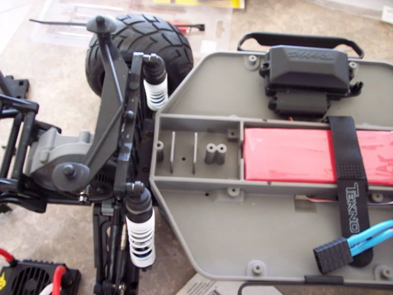

I am finished with it now.
03.18.2009, 04:13 PM
Clean, I suppose...

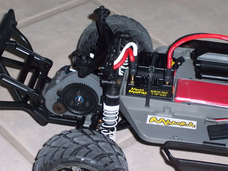

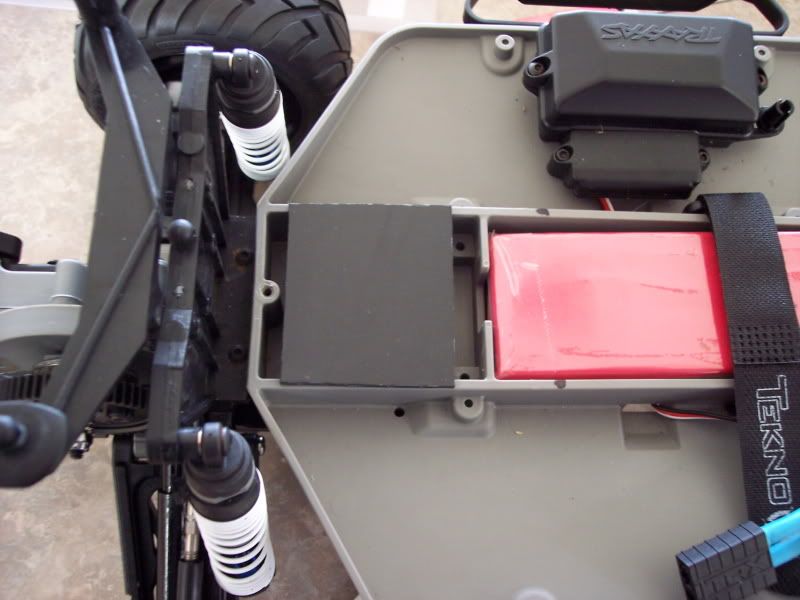

Q. if you were to remove the mouldings in that area under where the esc is mounted, would it actually fit/sit in there, or is the MMM just a tad too wide?
Jeremy1976
Posts: 537
03.18.2009, 04:18 PM
It would sit in there. I figure for now I am going to leave it as is just so I can get out and run it. But in the near future I do plan on getting out the dremel and taking down those plastic pieces and then lining the entire inside with some type of padding and then velcro it down with the zip tie still over the top.

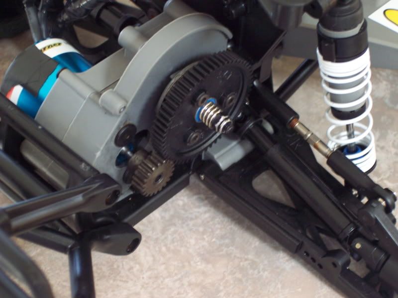

Is that Mod 1 gearing you are running? If so what are the details on the slipper/spur conversion to run Mod 1? I'd like to run my Medusa 50x3300 5mm shaft in a slash.

His looks to be 32p, to run mod 1 just get the monster gt spurs, and modify to fit center bearing, and slipper hub. 2 min mod.

Mine are 0.8 gears.
03.18.2009, 04:59 PM
32p and Mod0.8 are essentially the same, or at least VERY close that it doesn't matter...
He's running Mod0.8. There's no real need to run Mod1 in a Slash. You can get much better gearing options with Mod0.8 anyhow. Robinson Racing makes a ton of 5mm bore Mod0.8 pinions and Traxxas has about 7 different Mod0.8 spurs available that bolt right up.

I'm ordering the Alias Traxxas tire on the black chrome wheels. My stockers just are not getting any traction. My buddy has a VXL in his Rustler with the Alias tires and he is pulling mad wheelies. We were running on a infield in the dirt at a ball diamond today and anything over 1/2 throttle I was majorly sideways.. LOL We were both running the same 2s PQ pack. Within a split second on the dirt it is up to full speed and spinning...
Jeremy1976
Posts: 537
03.18.2009, 09:47 PM
After 30 minutes of wide open throttle and wheel spin my motor was 110, ESC 75, lipo pack 85.
