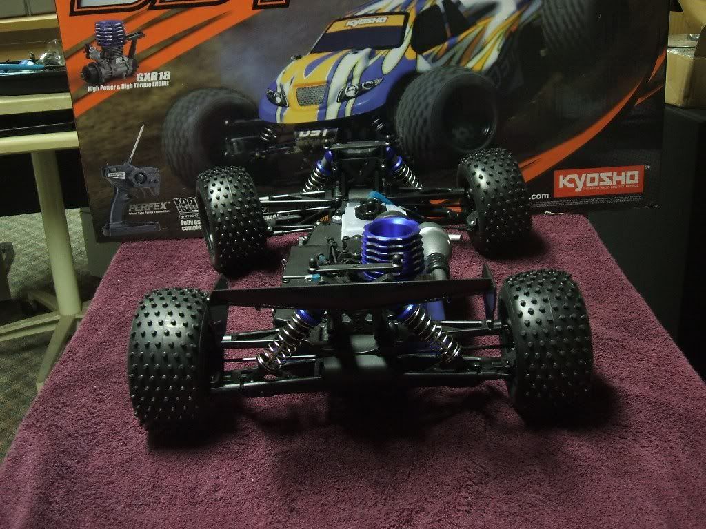

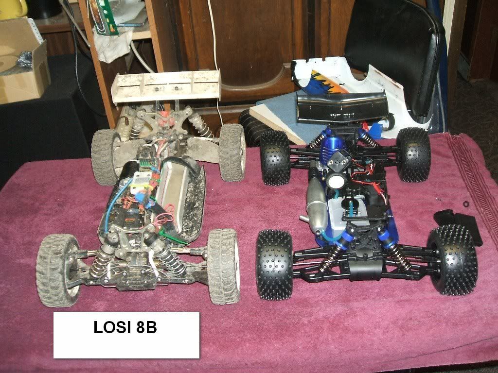

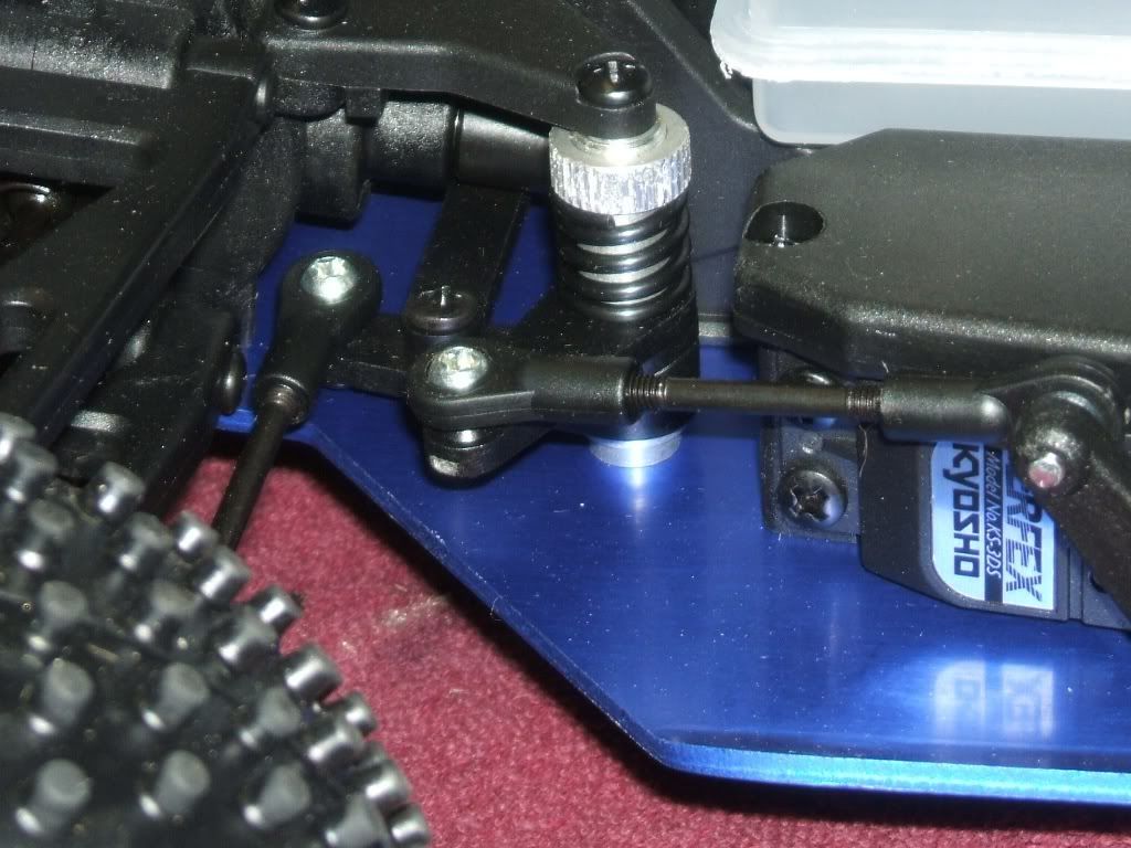

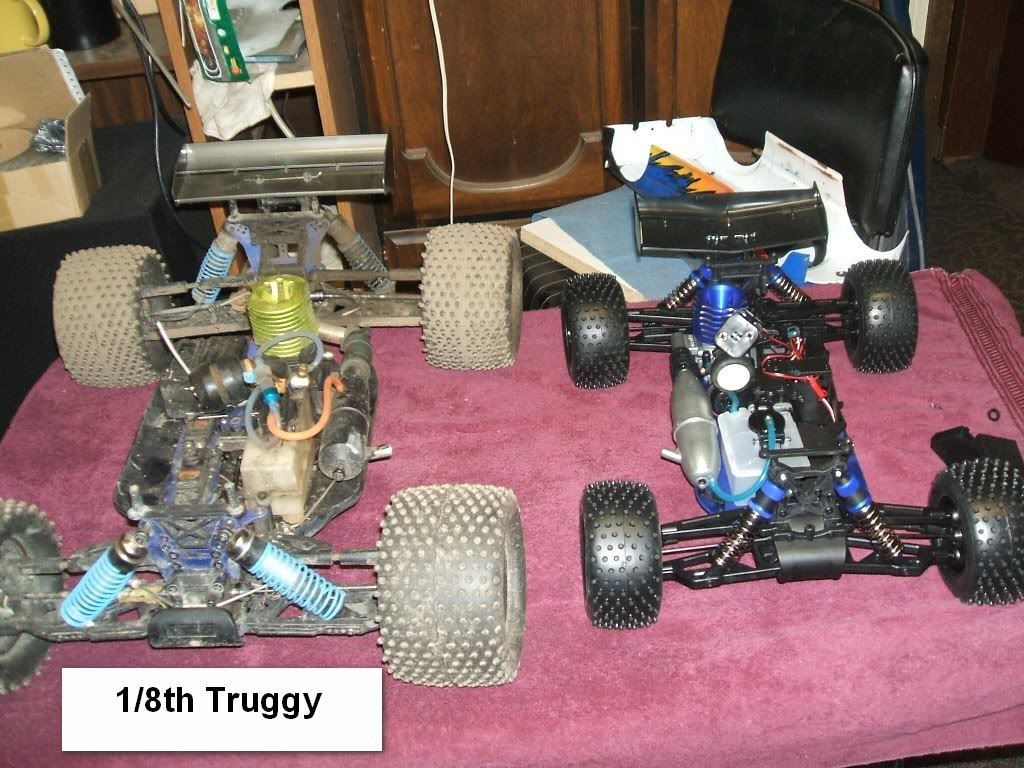

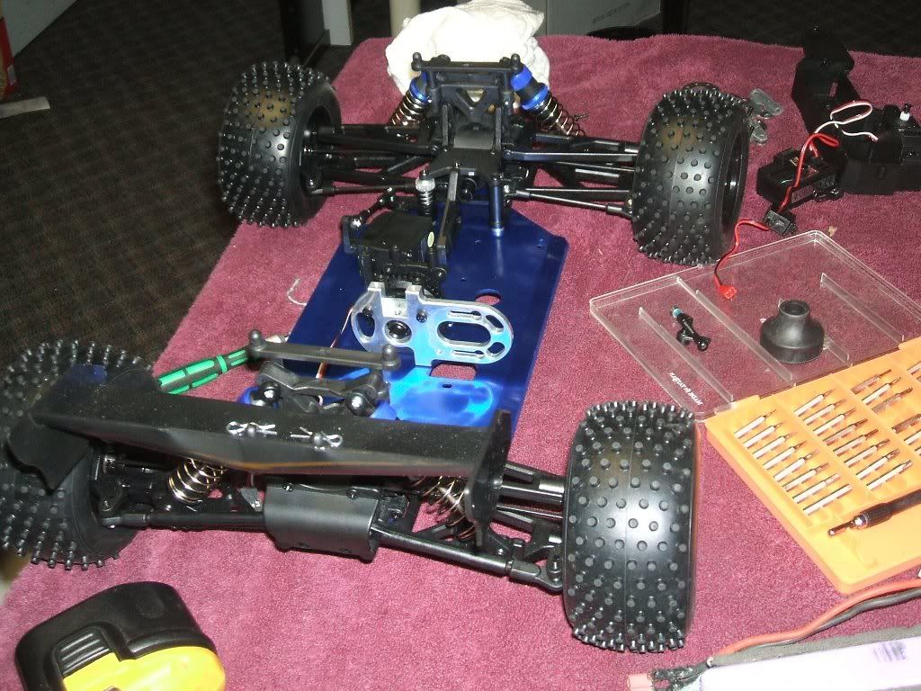

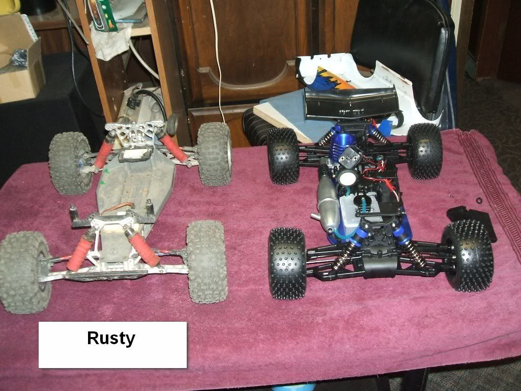

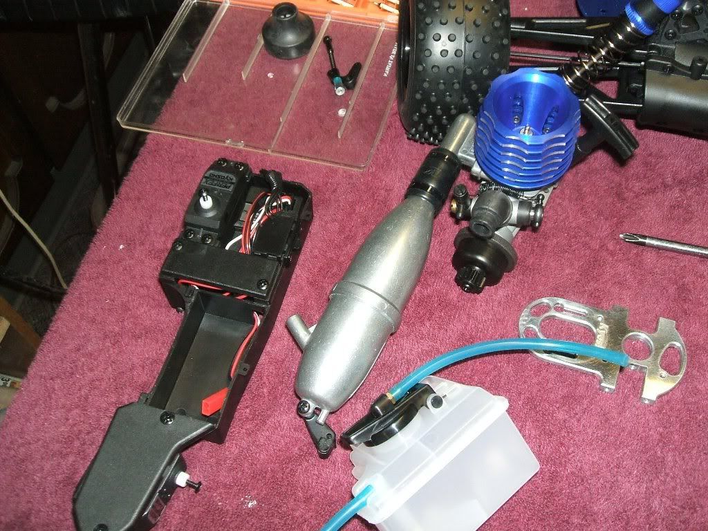

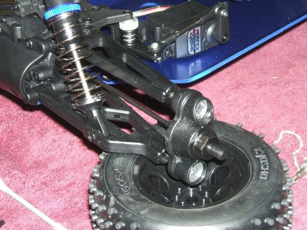

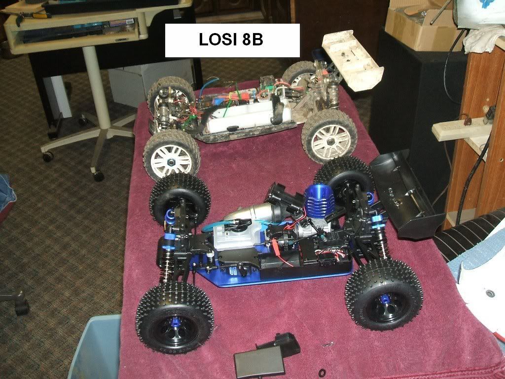

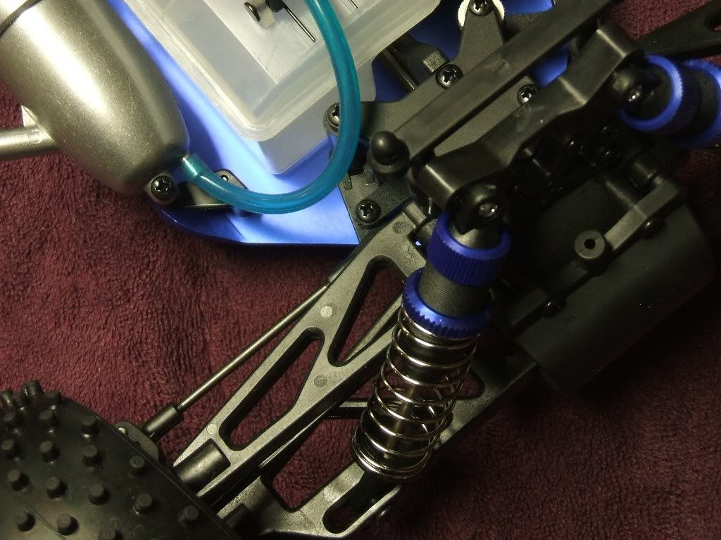

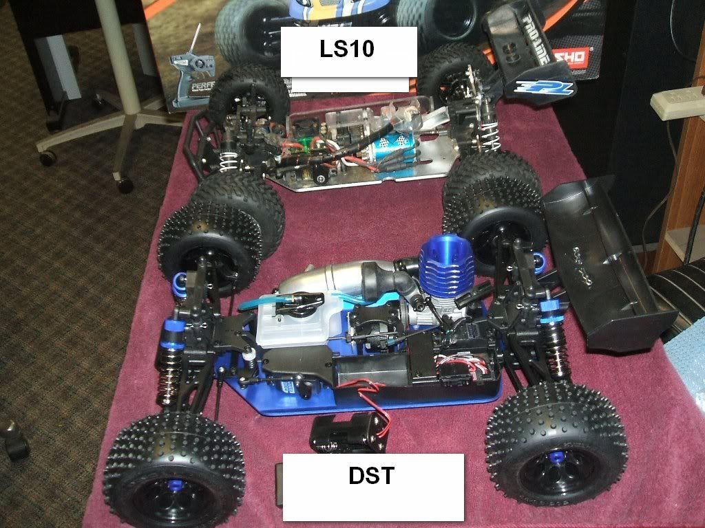

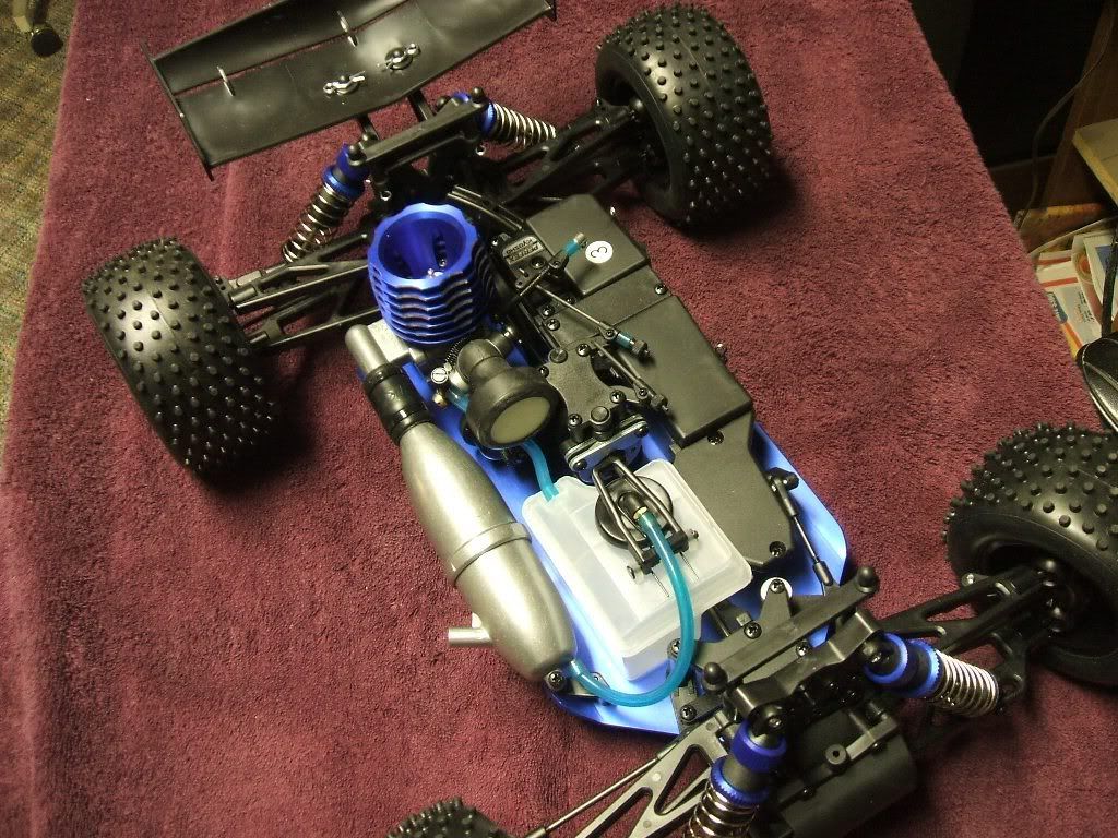

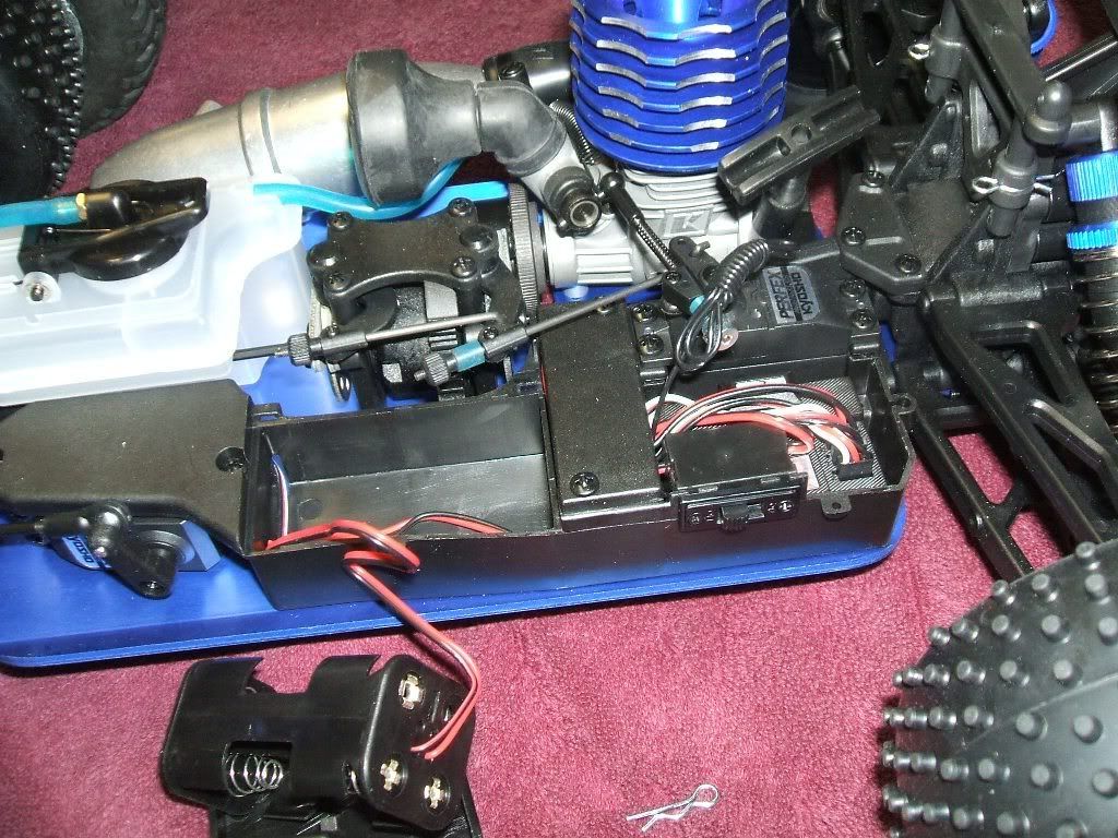

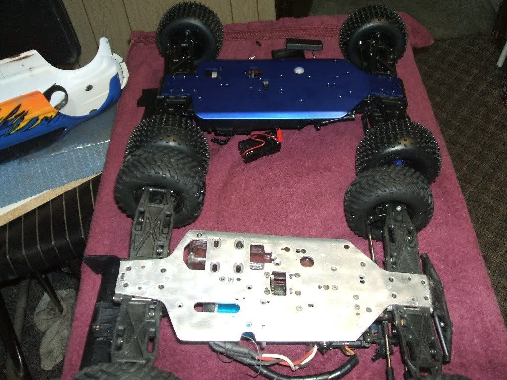

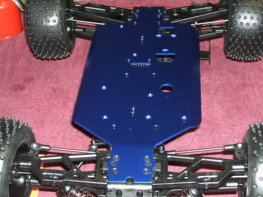

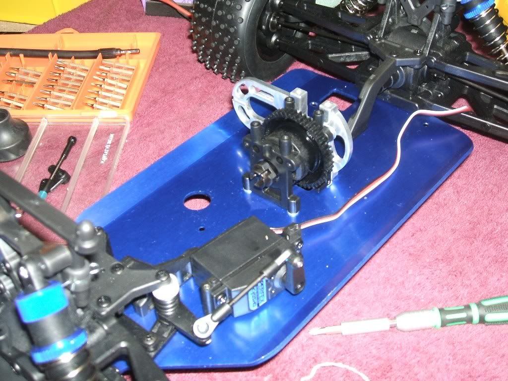

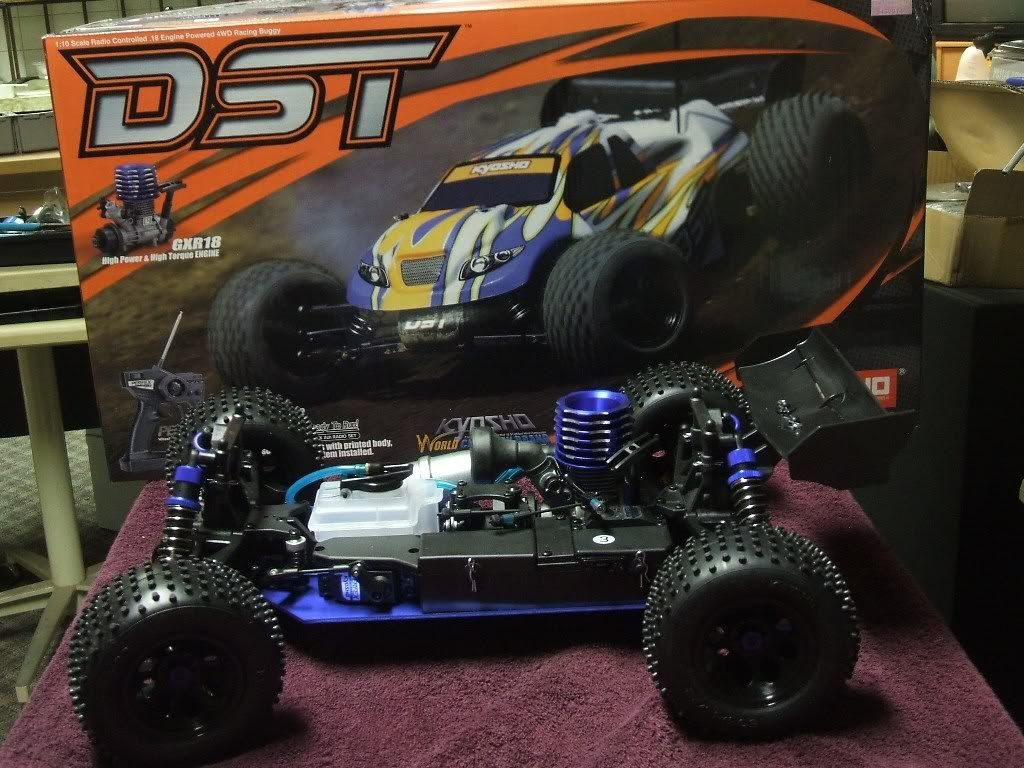

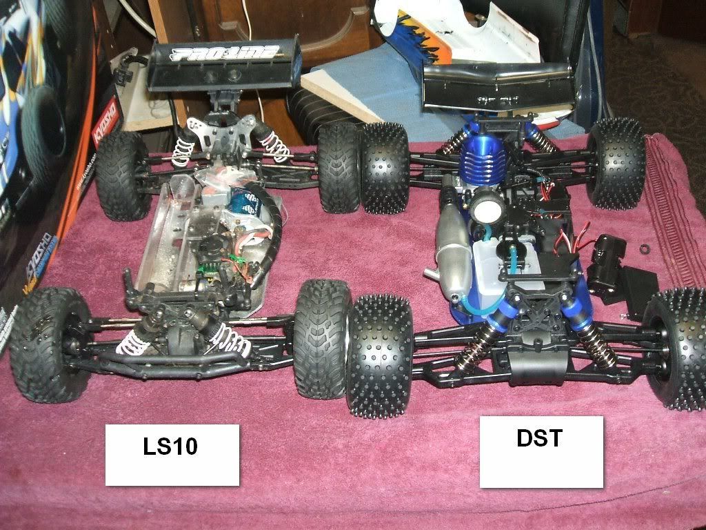

I bought the Kyosho DST 1/10th scale truggy a while back. It should of been here on the 19th of December, but UPS had it's hands full with the weather here. It showed up on Chrismas eve, so I held out until 12:01 before I opened it up. For those of you that were interested in it also. Here's some decent shots of it and some of the tear down. The photo bucket link has a lot more detailed photos. Just grabbed a few to put on here. I took a few comparison shots so you could see it up against some other familiar rcs. Excuse the STRR and Losi 8B appearance. They are up for the winter and awaiting to be teared downed, cleaned, and gone over.

It a little wider and longer then the LS10. Not getting the LS10 new the comparison for me is a little one side. Not really but the DST is shinny. The items that came stock on the DST that appear to have the upper hand over the LS10 would have to be the center differential. Nice dual manual brake setup with easy independant adjustments for the front and rear. The shock are a nice set of Kyoshos lower end shocks which are better then any other RTR plastic shock I've seen. They have the adjustable ride height to them. They are the same design that I had on the Inferno ST before I started upgrading it to the STRR. They worked well on it. The knuckles and pillow balls are a nice feature that I would say is better then the LS10 uprights.
It definalty looks like a 1/10th when you sit it next to the truggy. Man that truggy needs a good cleaning.
It doesn't next to the 1/8th buggy though. In size it is close but the buggy is built with 1/8th parts and you can see the difference in the cvds and turnbuckles.
I will be putting it to the test to see how tough it is and handles soon. Well hopefully soon and I suppose that depends on when the snow melts away also. By the looks of the winter so far that part could be a long time out.

I've read in other forums that the stock steering servo has failed on others pretty fast. A few have also indicated they have broken some arms. Don't know if those are user errors or a indication of what I can expect. Haven't read much about the shafts breaking or the diffs giving out. I ordered some extra arms and spur gears to start the spare parts bin. The rear tie rods on it look pretty stout.
The bearings that hold the center differential in it bulk are a 12x18x4 bearing which figures. Kyosho always seems to just a little different somewhere. I had the RCM Kyosho motor mount from the STRR conversion and was going to use that. Well the bearings are too big. I tried the sandwich trick but it will put the motor too far back from the spur. The pinion will be on the very end of the shaft. So that's were I am at now. I am working up a custom mount using Mikes motor mount as a template more or less. Pretty hard to come up with any improvements over his design.
Here is the photo bucket link if you want more.
http://s212.photobucket.com/albums/c...DST/?start=all
I will have to post a pic of the way the center differential is setup with a top that seal the differential, then the spur (with a hole in the middle) screws into the diffential. You've probably seen what I am talking about.
