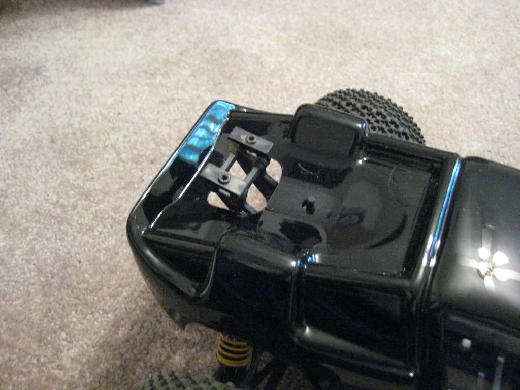

I bought a Rustler body for my CRT.5 when I got Mike's chassis kit. Wheel base length is just about perfect, I just had to remove my bumper. I cut a rectangular shaped hole in the rear for the wing mount to poke through instead of hacking to rear end to bits. Body structure is still very ridged in the rear and the rounded cuts will keep the body getting stress fractures.
