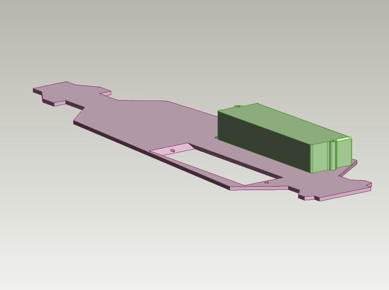

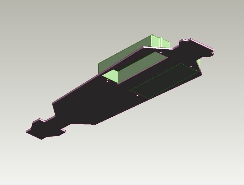

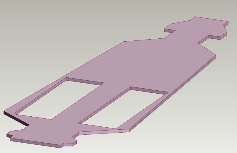

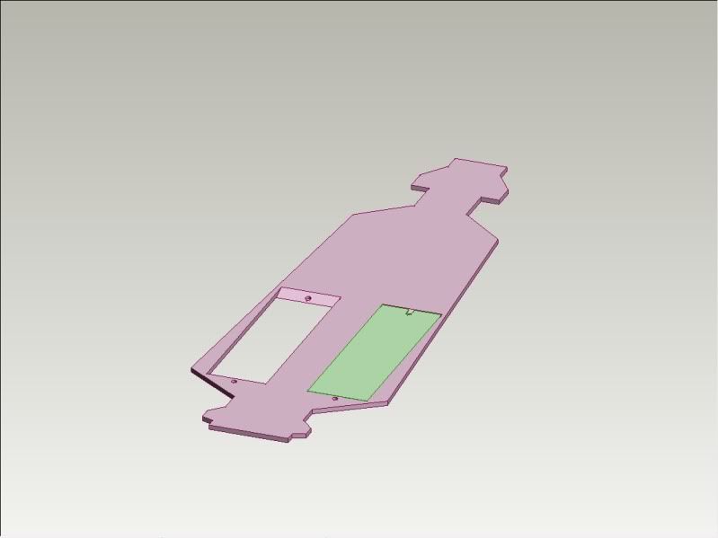

Yeah, this idea has reared its ugly head yet again. This past weekend At the track I realize that most conventional battery containment systems have become a pain to racers who wish to perform battery swaps and run longer mains without losing much time compared to the nitro's. The past day I have been trying to think of something that would be quick change (less then 10 seconds) and eliminate the hassle of plugging in the batteries you are swapping in.
Secondly it has to be able to handle the abuse of racing. the jumps, tumbles etc. So the hold down system must be sturdy.
So My idea is this.
- Base the design off of Team Novak battery trays and Mike's 2s Hardcased lipos.
-Cut a holes in the chassis the same size and shape as the batteries
- Flip the trays upside down so that packs are bottom loading
- Incorporate Male bullet connectors into the battery tray so that when the battery is inserted it automatically connects to the speed control wiring. without the need to plug anything additional in.
(any ROAR battery with 4mm bullets would work. see here, reedy, Rc-monster)
- The doors i have mocked up have a beveled edge which would line up with a beveled edge made into the chassis to keep the door from moving without the need for another quick release fastener.
There are only a few things that are holding me back.
-What quick release mechanism to release the battery doors
-Machine work on the chassis
-Battery selection
Plans and updates
-Now that i have something to look at. I thik it may be easier to mount the tray to the chassis by the sides and leave the front/rear open for the quick release mechanism.
- The quick release mechanism is to be a dzeus fitting- They are quarter turn quick release fasteners used on aircraft and race cars- they are plentiful at my house :)
- Now that my dad has seen me and my truck race hes taking the whole rc thing more seriously(finally) and Im in the process of talking him into getting me a hand mill He is the one that sparked the "Trap door" Battery tray idea.
Ill stop blabbing, here are the pictures!

I think that this would weaken the chassis too much - The key is the locking mechanism...
Mike and I had discussed ideas and he was working on something - The issue is by the time you build it electric classes will be out with 12 min mains and hence no need for battery swap...
I hear you on that, but my car has a giant composite brace spanning the entire car. i dont think strength will be a problem, and not all mains are the same... Just because i run electric doesnt mean I shouldnt be able to run 30 minute mains or enduros dont you think?
05.11.2009, 09:06 PM
I hear you but the question is with so many e's coming from OEM's without this technology - races are likely to be to the common denom i,e, around 12 mins

This is one of those great ideas that seems so simple and yet so hard to carry out- I get 'engineer's block' with stuff like this sometimes.
My old Hornet had a bottom access for the pack and I miss that simplicity, it would really help if mfr's would standardize cell/pack size like back in the day. Not that they were much more standard, there was just a lot less choices haha. 6 cell 1200 mah Ni-Cad baby! Hump packs, the memories...
Sorry.
The simplest way to add some rigidity back to what you propose is to do a 2 level chassis, or add some bends/angles to the edges wherever material is lacking for cutouts.
I think you already knew that, but a chassis with a channel type center (Revo) would obviously be much easier to do that with. You might consider side loading with a vented box like the E-Revo if your body would allow.
05.11.2009, 09:28 PM
the design seems entirely too complex. all you'd need is two male plugs mounted standing straight up on the chassis, soldered 90 degrees to the wire, then push the battery upside down onto the male bullets. have fixed sides and spring loaded holding tabs on both ends. done.

what about a trap door like on the e-revo and savage?? just put the bullets in the tray and it plugs right in when you insert it...
brushlessboy16
brushlessboy16's Avatar
05.11.2009, 10:37 PM
Originally Posted by whitrzac View Post
http://home.comcast.net/%7Etruerc/re...eady_packs.htm
the hard case 6000mah one.
Thats the general idea from the beggining.
Thinking all this though- this is definately not the best idea for the job...
Sure would be cool as hell.
....Back to the drawing board.
