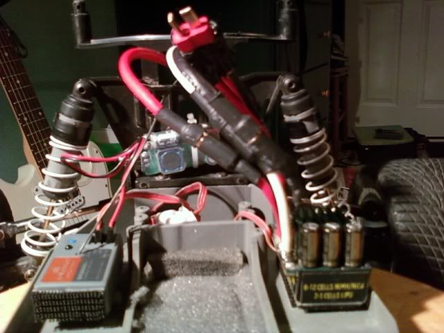

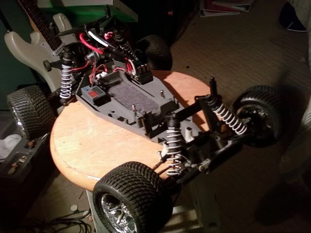

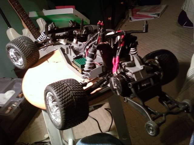

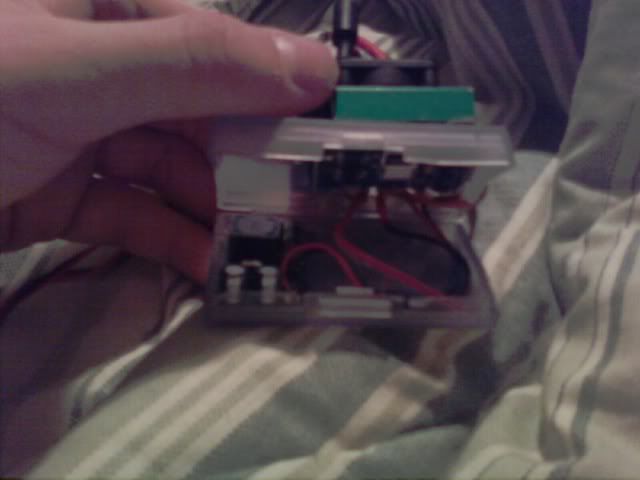

Just starting this thread for the rustler roller I got from lincpimp recently, and its gonna be my truck for speed runs, bashing, and just general playing in the street.
So far this is my setup:
mod 1 gears from a revo (14/40 ratio)
Traxxas 2055 servo (stock emaxx)

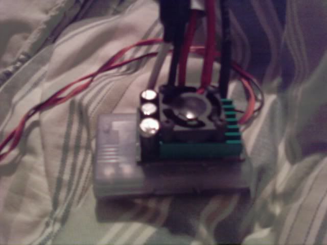

Mamba Max with BEC disabled and 6.5mm bullets attached
Fiegao 8L Finned(well, not really anymore)
Protek 4s 20c 4000mAh lipo
Noname brand BEC from TrueRC
Spektrum SR3000 reciever
3 road rages and one road hawg for tires
yay pictures!

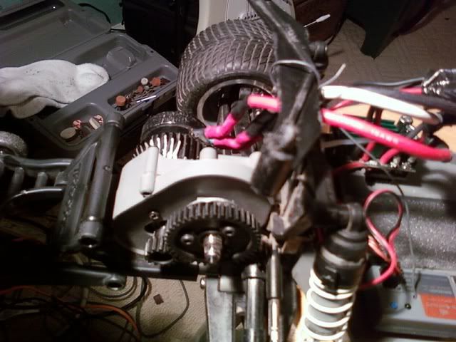

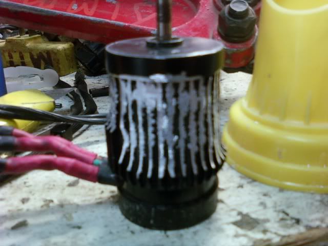

I had to eat a little bit out of my finned motor in order for it to fit in the tranny housing

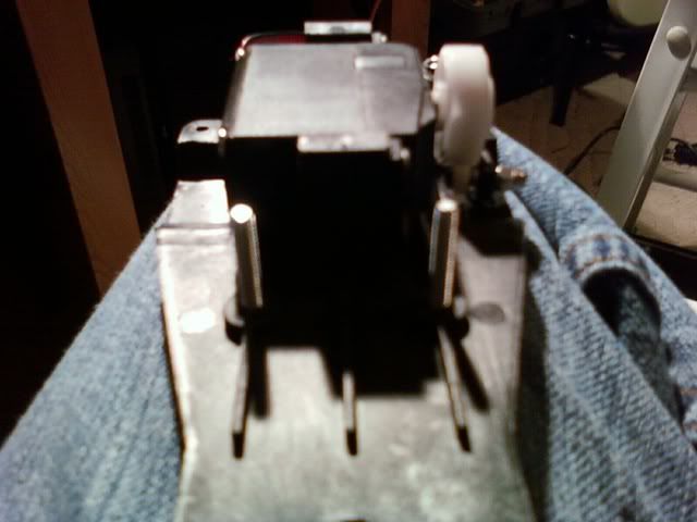

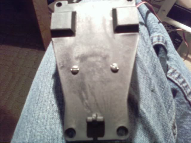

And hopefully this little mod will save me lots of trouble... My upper chassis plate(the servo mount and bellcrank posts) kept breaking due to the tiny hollow plastic tubes... so I threaded 8/32 screws through the plastic, and then threded the plastic tubes back ontop of the screws and it all fits perfectly. hopefully they wont break right off anymore.
