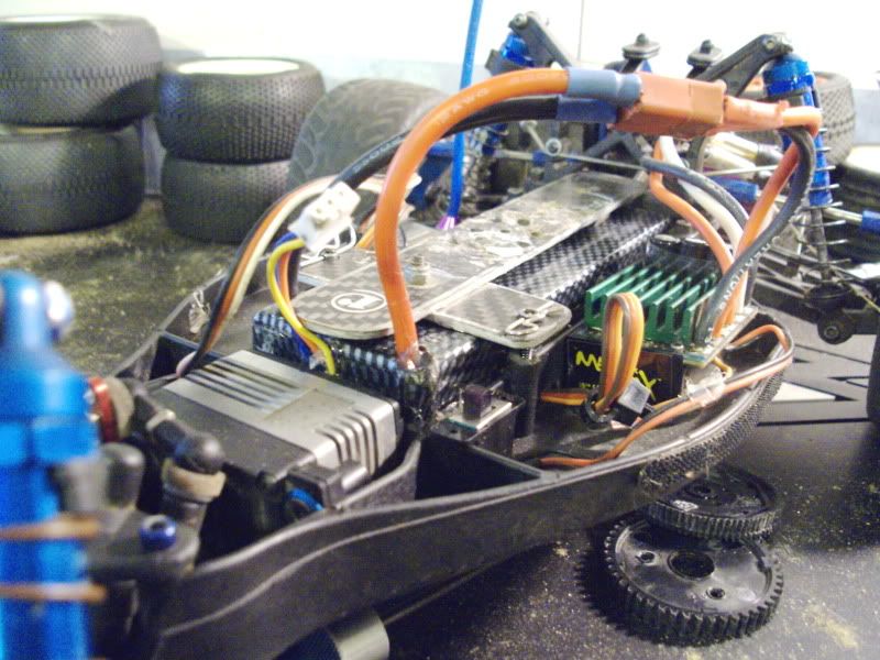

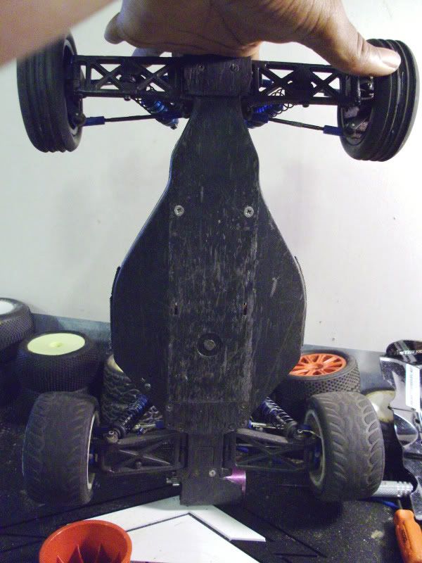

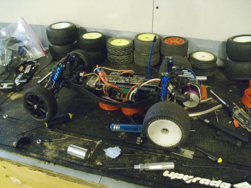

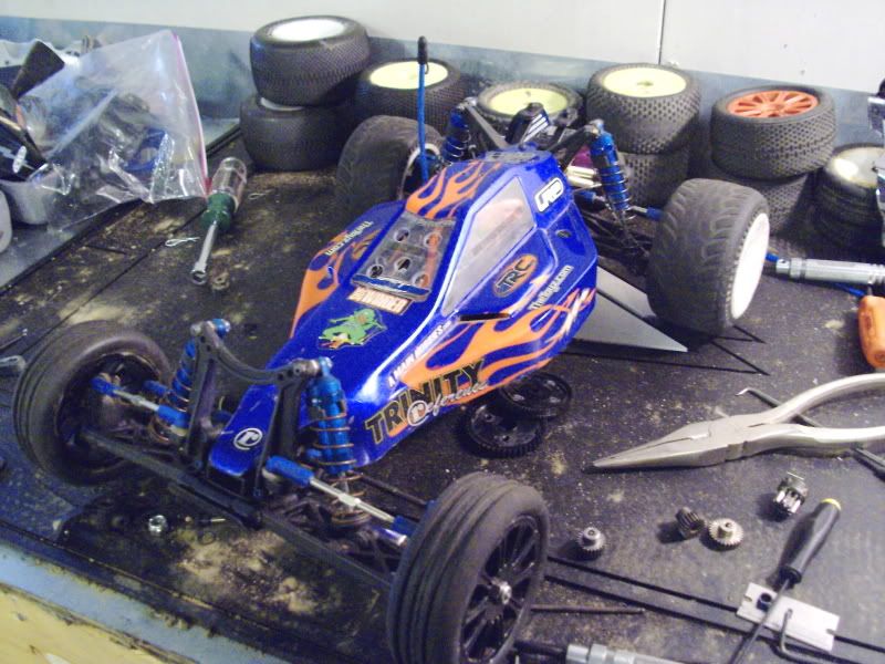

Here is my brushless Rc10B4rs
-Ds1015 servo (a tad overkill)
-Currently a Mamba max esc(came with a sidewinder)
-Feigao 7s 5070kv
-2s 4100mah smc packs and 2s rcm 5200mah packs
-Geared 22/86
-All RPM ball cups
-Aluminum rear hubs
-FT Milled motor plate
-MIP cvd's
The speed controller no matter the gearing gets hot- 160 degrees. the mamba max and the sidewinder both do.. i think its because of the linear bec... might try and stuff my MMM into the little car.
the motor gets to ~150 but its to be expected.

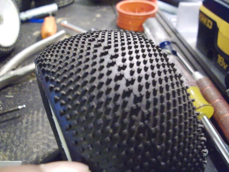

-Got a great deal on these losi x2000 tires, 10 bucks shipped from ebay and they are like new.
brushlessboy16
brushlessboy16's Avatar
06.19.2009, 12:44 PM
more pics.

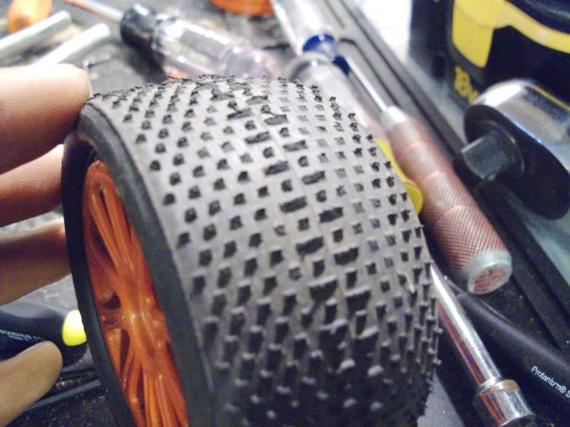

Those are a set of buggy inside jobs, buggy bowties (bald), Truck Inside jobs,
and truck Holeshots.
Big thanks to skellyo for sending his spare parts to me PIF, the truck tires look sweet on the buggy!
