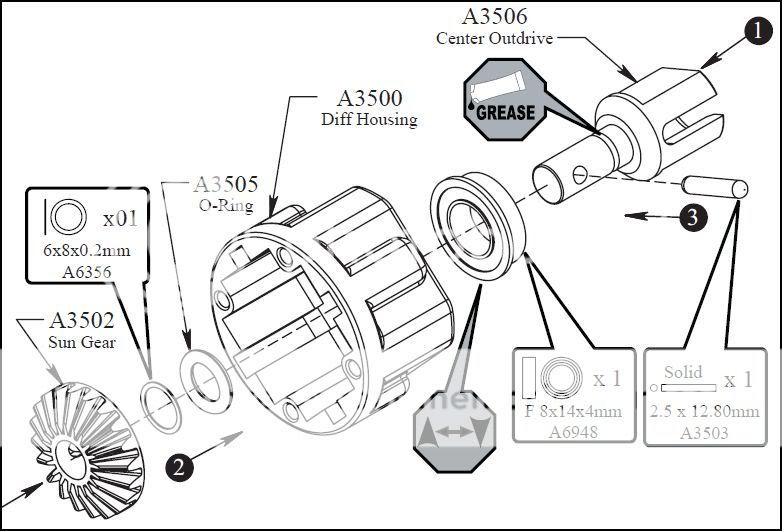

I have just taken apart my Center diff and was cleaning and going to change the oil when i was inspecting each gear for wear, i found that one of the SUN GEARS has a small chip on one of the ribs. Its very small, and i dont see it really being an issue, but i am new to this so i could be wrong. like i said its like a little chip of metal is missing. so very small. thoughts suggestions?

AH! here we go, i was messing with the camera and was able to get these great pics! Im def going to replace, i didnt know my camera could take these good pics. Looking at these gear close up u can really see the poor quality, lots of divits and pock marks, these are the stock 8ight-t 1.0 gears. Who makes better replacements?
