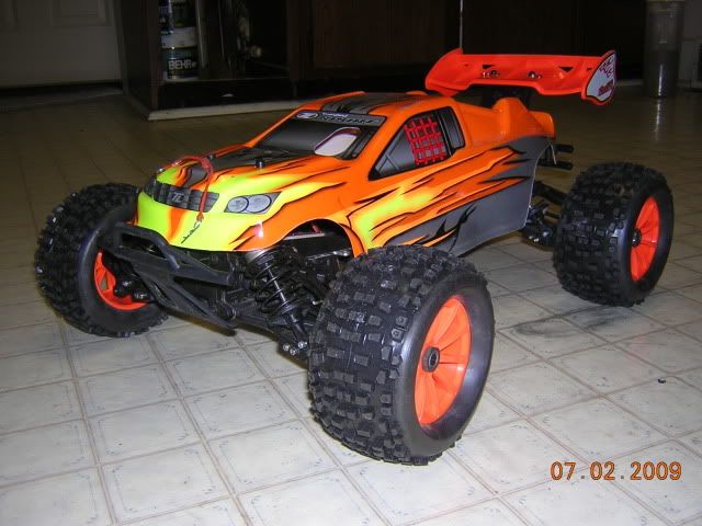

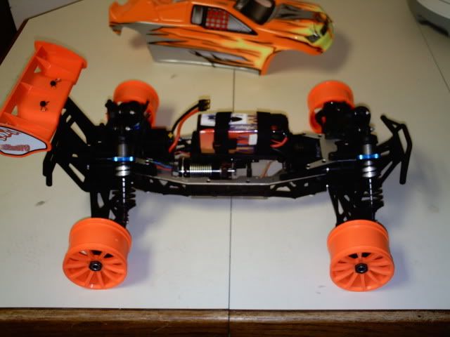

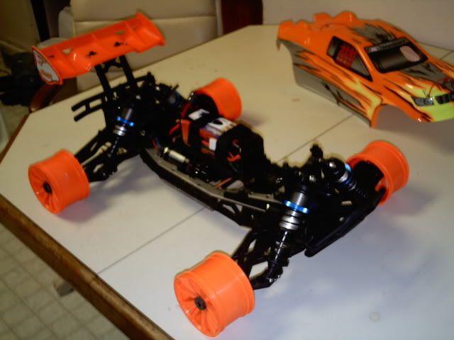

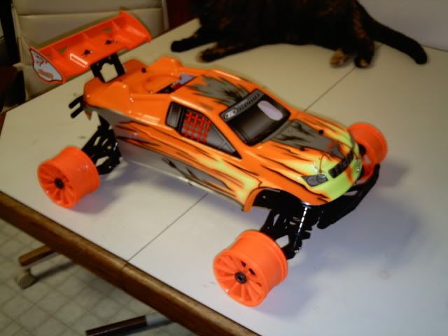

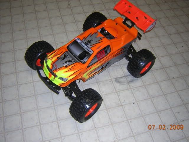

well Project Jump Truck is starting to take shape, im still in the process of makeing parts and doing mock-ups but here are some blurry cell phone pics to wet your appetite
real pics comeing soon

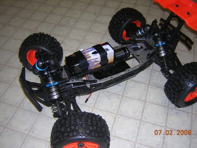

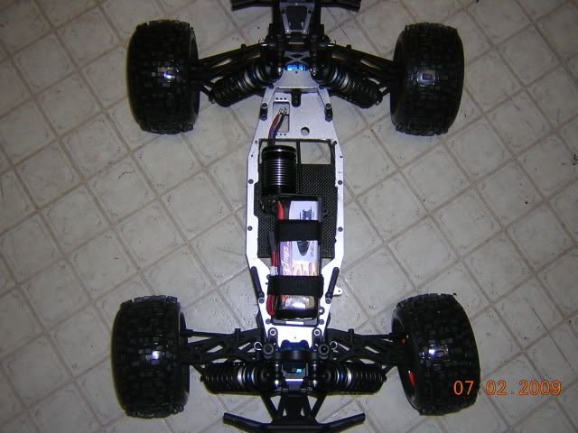

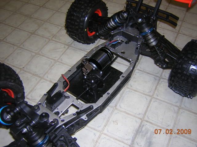

Update!
-tires are taped and glued on the wheels, (its going to need wider offset hubs)
-4.5mm carbon fiber diff mount is almost done
-added losi heavy duty diff outputs and put 10k in the canter diff (7k front,3k rear for now)
here are afew better pics for the people who wanted to see the center diff
next update coming soon will be the carbon fiber battery tray mount and balancing the truck

Looking good, do you plan to do a cross ways batt tray in front of the CD?
Alot of Savage parts for sale!!!
Find all posts by lincpimp
9
07.03.2009, 12:13 AM
I'd bet it'd be in the rear of the chassis

the battery and battery tray will sit like this, on top of a 4mm carbon plate
